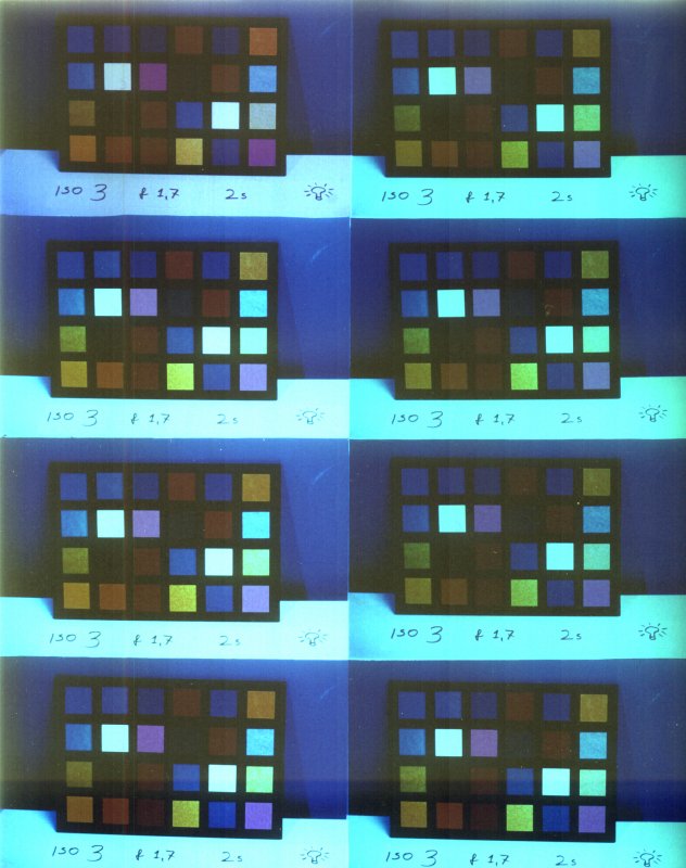

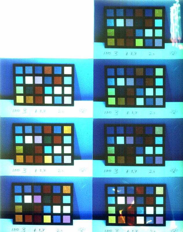

I meant that to get some white I need so much exposure that there is no black and the other colors get bleak and unsaturated. Actually they get ugly before white becomes white.
From what I see contrast rather too low than too high but it might be because of the cyan fog I couldn't get rid off.
I've scanned some prints but my scanner is really atrocious and I'm not sure if the images are really relevant.
Left image: top left has 120y 100m, the rest is at 120y 40m and some variations in all directions.
Right image 80y 40m and additional amber lightning gel. The top left white area has actually cyan cast in some parts and is white in other. I exposed it heavily but unevenly with a torch. Areas that look white on scan are not white on prints.

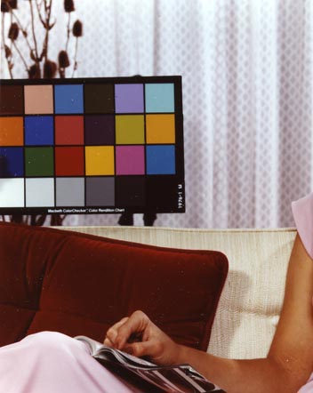

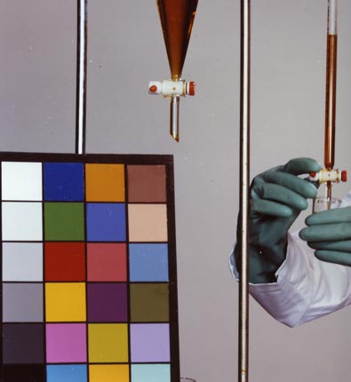

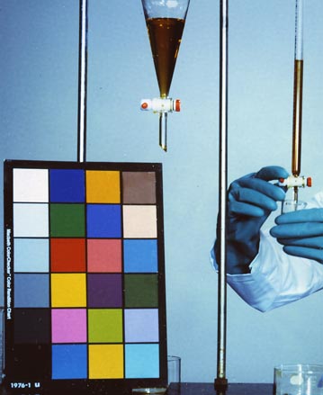

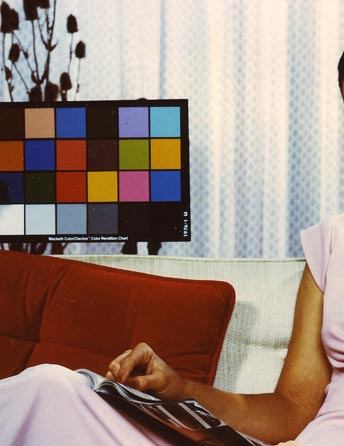

Photo Engineer
Apr 19, 2005
29,018
Rochester, NY
Test charts
Here are 4 pictures. The check in each pair iis from a 4x5 internegative made from an E6 transparency and printed on Endura in RA chemistry. The experiments are direct prints on Endura in a cross process from the 4x5 transparency.
The Girl on couch is pretty good, but I'm not happy with the color balance of the Girl in the lab. The wall is supposed to be gray. You can see that the neutral scale is not perfect in any of these. My home made internegatives are not perfect, being made on Portra VC, but in the absence of the real internegative film, it is the best I can do.
BTW, these are Kodak Girl pictures of some of the 'unknown' Kodak Girls. I don't have ownership of these so I cannot show the entire pictures and faces. These are 'gifts' from old friends saved from a trash can many many years ago.
PE

Pretty interesting, thanks! So the cyan layer has a steeper curve than the other two and makes the gray turn blue when the other colors balance out? Would this have to do with the paper being designed for printing with the orange mask in the negative?
Photo Engineer
Apr 19, 2005
29,018
Rochester, NY
Well, first off the cyan layer does not have a steep curve in either negative or reversal processing. However all layers suffer from a bit of crossover that varies with process and paper batch in the cross process. And, since cyan is on the bottom, you have to insure that it is 'well done' to get white whites, but you have to do it in such a way that it does not cause a lot of crossover.
The girl in lab is not an example of crossover, but rather is one of imperfect color balance. The girl on couch is more of an example of crossover even though it looks better. So, depending on scene you can get a variety of results. You can see that the flesh tones are pretty close in the two on the left, but the curtains don't match at all. If you want a better example, the Inspiration Point pair I posted previously is probably the best comparison.
A 16x20 of that one is on the wall here. Also, in the gallery are some cross processed examples.
PE
