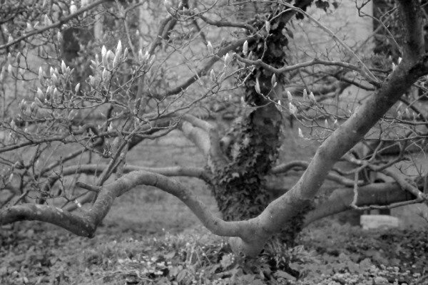

I've been working towards making black and white slides recently. After some trial and error, I've managed to get a couple of usable slides, but would like to improve the process further.
This is a photograph from the test roll with the levels stretched to fill the contrast range.
The film was Kentmere 100 shot at box speed. I used D-76 stock without hypo as both the first and second developer. The bleach is equal parts 2g/l potassium permanganate and 1% sulphuric acid. This is half the concentration recommended by Ilford, but after reading suggestions that the stronger potassium permanganate bleach could damage the film emulsion, I decided to dilute the bleach and extend bleaching time to compensate.
First development was for 21 minutes, continuous agitation for the first minute and one inversion each minute thereafter. 9 minutes is the starting point for negatives in this developer, so 21 minutes must represent a one or two stop push. After trialling 14 minutes as a developing time, 21 minutes gave a slide that was much brighter for projection.
Bleaching was continued for 16 minutes with continuous agitation, to be certain of removing all the developed silver. A shorter time may have been sufficient, but the extended time did not appear to harm the emulsion. Re-exposure was for one minute on each side, 30cm from a fluorescent light tube. Re-development was continued for 16 minutes with frequent agitation.
In full room light, I cut the film into single frames for fixing individually in a measuring cylinder. The first frame was in the fixer for less than a minute when I noticed a reduction in density around the perforations. I redeveloped subsequent frames for 5 and then 10 minutes, again in stock D-76. Only after 10 minutes of re-development did the image stay on the film, clearing slightly after 2 minutes in the fixer. It's hard to say whether the fogging exposure or the second development was insufficient, causing the removal of the image by the fixer, or perhaps both were insufficient. The film was exposed to normal room light for a long time after re-development for the first time and re-development for the second time without any ill effects, so I suspect that increasing the second exposure to a much longer time would be fine.
On examining the slides that I have so far, the brightness is good. Although there is detail in the shadows and highlights, can the contrast be increased? I have a feeling, as the first development takes 21 minutes, that ISO 100 is the wrong speed for the film in reversal. Can shooting at, say, ISO 50 and reducing the development time give better contrast? Or should a different developer be used specifically to increase the contrast?
I look forward to hearing your suggestions, especially on film speed and which part of the process to change next.

Contrast and brightness are controlled by first developer, whereas all other process steps are meant to run to completion. Second, whatever is dark after first developer, will be bright after process completion and vice versa. Once you understand this, you know what to do when you want to change the appearance of your slides:
  1. If slide contrast is too low, then you need to extend development in first developer. If contrast is too high, then first development needs to be decreased.
  2. If contrast is ok but the highlights are too dark, then either exposure is too low, or first developer is too weak (too dilute, shows exhaustion)
  3. If contrast is ok but the shadows are too bright, then either exposure is too high, or first developer is foggy.
Note, that a first developer may well become too foggy for reversal processing, even if it is not foggy for regular B&W development, since first development is typically much stronger than regular B&W development. Since first development is very strong (would be considered a massive push for regular B&W development), some B&W films give higher speed with reversal processing, compare e.g. Adox Silvermax 100 with Adox Scala 160 (allegedly the same emulsion).
Thank you for this advice. Assessing the film again, I think the problem is mainly the shadows being too bright. Highlights have gone to almost the same density as the unexposed end of a negative processed roll, but still show a good amount of detail. With colour slides, I'd expect there to be a complete loss of detail in overexposed areas. Is the same true of black and white film when reversed?
(...) The bleach is equal parts 2g/l potassium permanganate and 1% sulphuric acid. This is half the concentration recommended by Ilford
First development was for 21 minutes, (...)
(...)can the contrast be increased? I have a feeling, as the first development takes 21 minutes, that ISO 100 is the wrong speed for the film in reversal.
In my humble opinion,
Almost all the times reversal is done, the first developer is chosen to be a developer that gives HIGH contast, aka a "contrast working developer". D76 is far from such a developer. Your first development time is very long because D76 is a developer for normal contrast with good compensating properties, which prevents contrast from going too high. Slides are to be developed to a contrast index way, way higher than negatives.
So i'd suggest using other first developer.
Bleach: Why did you not use Ilford's recommendation? If the bleach doesn't work fully, they you would not get the clearest highlights. Perhaps you're (wrongly) blaming the film's speed on what appears to be a problem with your first developer and bleach.
For second developer you need to develop to completion and here also a strong developer would help.
Make sure the film gets enough light at the reexposure. And of course, that 2nd developer is strong to work to completion.

Thanks, changing the developer and rating the film at a faster speed both sound like good ideas - but not at the same time. Although Ilford suggest PQ Universal developer, would a speed increasing developer such as Microphen give more contrast while reducing development time? The Digital Truth chart suggests adding 30 seconds to the time for Kentmere 100 to give a one stop push (up to 9 minutes from 8:30).
I don't think the bleach is a problem here; the highlights look as clear as the film base, but I'm surprised at the amount of detail they contain after the shadows appear to be over exposed.
Platelayer,
For reversal process you need a CONTRAST WORKING DEVELOPER (emphasis added here). This is a developer that used in normal circumstances (ex. for developing negative film) would create a crazy high contrast image. A paper developer (i.e. Dektol) gets close to such a developer. Ideally, you would also want the first developer to be a low fog developer.
Microphen is not such a developer. Microphen is a "normal contrast, speed-enhancing" developer suitable for pushing, nothing more nothing less. Please do not consider what you are doing (on the first development) as "push development", because we want the first developer to pump up the contrast even more.
PQ Universal is in reality a paper developer which, if you diminish its strength, is suitable for developing negative film as well. I think the Ilford recommendation will make you use PQ Universal in the strength normally used for developing PAPER. This is good because you want to make PQ Univeral work HARD and give HARD contrast.
An alternative to PQ Universal would be Foma Universal Developer.
There are some differences between color reversal and black&white reversal, but as far as first developer is concerned, they are quite similar. I interpret your above statement as "contrast is fine, highlights are ok but shadows are weak", which means you should add restrainer to your first developer. I recommend starting with 0.5 g/l Potassium Bromide increments until the shadows are where you want them, then adjust first developer time to get the highlights where you want them.
About exposure: remember that the shadow region of a reversal image represents the toe region of a negative. If you underexpose, detail will get lost in toe region, which translates into lost detail in the shadow region of your slides. Overexposure, on the other side, can be easily compensated for by reducing first development, which means it only becomes apparent if contrast turns out too weak for your taste.

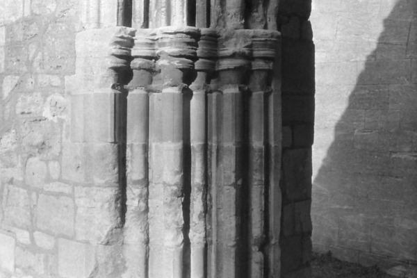

Thank you again for all the advice in this thread. I shot some more Kentmere 100 today, I'll let you know how I get on developing it with a different developer as soon as it's done. Eukobrom and Dektol are sold as 'print' developers alongside Ilford PQ - using any one of these might give better results.
Platelayer
Platelayer
Mar 10, 2017
18
West Midlands, UK
I shot another roll at the weekend with the camera set at ISO 160 and paying close attention to the exposure throughout. I think this frame shows best what the change to the exposure did for this roll. The shadow tones are looking more natural, unlike the previous roll where they had became a bit washed out. It looks much better when projected with the deeper blacks.
Processing was the same as the previous roll - 21 minutes in D-76 for the first development. I'll hopefully be getting some Ilford PQ soon, I look forward to seeing what difference that makes. In any case, I look forward to development being a bit quicker.
