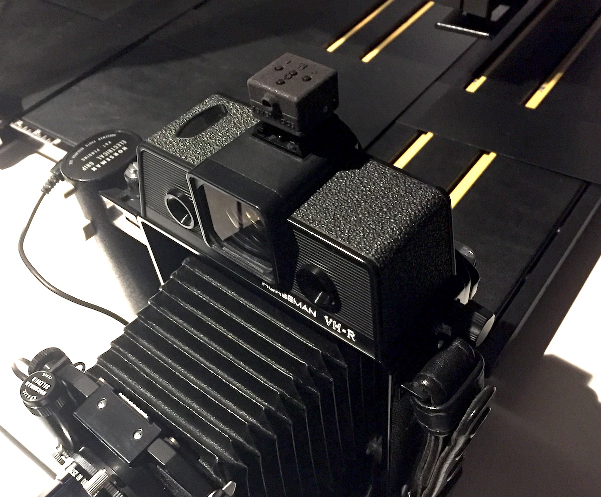

Radiant makes some good points, especially if a large portion of sky is in the 40 degree view of the Reveni.
Just to clarify why I like mine, I use it with the little 16mm cameras, Rollei 35, and 6x9cm technical cameras. You might think the technical camera is so big, adding a massive Luna Pro to the kit is nothing, but actually just the opposite. Since the camera is so big, any extra weight is horrible.
