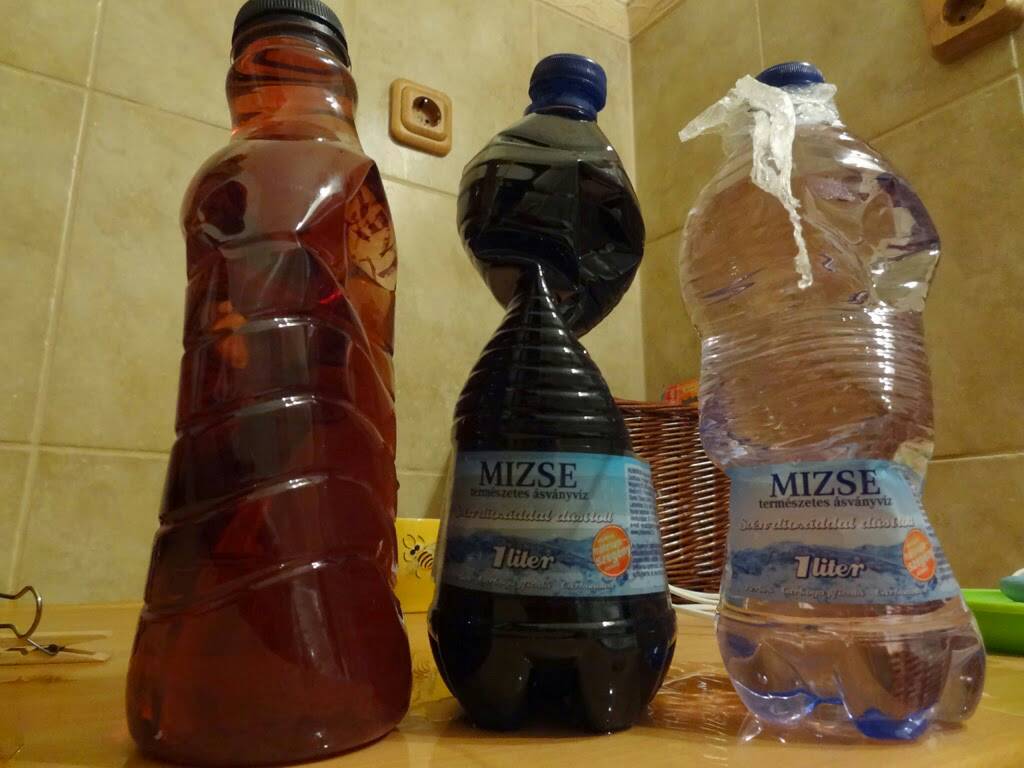

Miha, that Tetenal last forever for c41. Keep in airtight the mixed chemicals and follow the time extension advised.
I solely stopped using my 1 Liter mix after 20+ canisters because of the volume loss over the time.
That's my specialty bottle [emoji2] :
