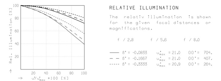

6x9 CM coverage in enlargers sometimes comes in the form of a 4x5" enlarger.
Modern Multigrade papers are excellent. I use them exclusively for my fine prints.
I don't like powder. I used Ilford MG paper developer, but the bottle still goes bad after you open it, even if you don't use it, so I went back to Dektol.
Currently I'm splitting Dektol bags in half and vacuum sealing the remaining. This is an experiment and I'm not recommending it, though I'm doing it.
All enlarging lenses have light falloff, so, you will have to deal with it even if you own a 8x10 Durst CLS with the finest lenses.
