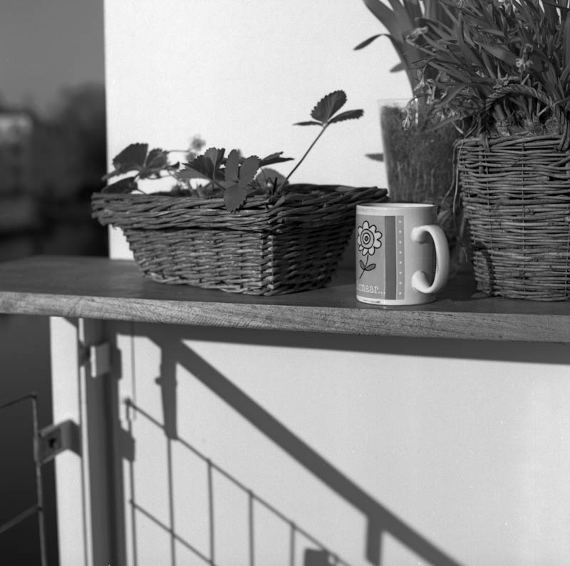

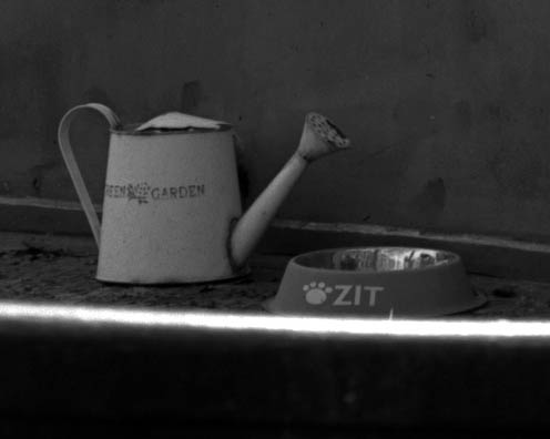

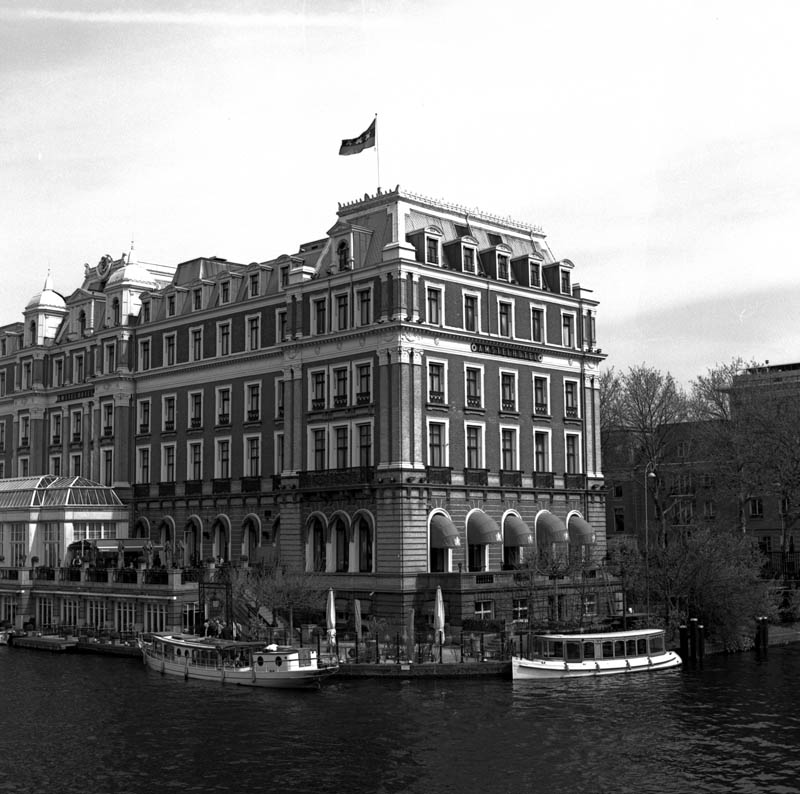

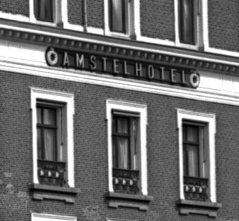

Some samples (scans from negs with flatbed scanner, no adjustments, no sharpening, H'blad + 80 CT*):
