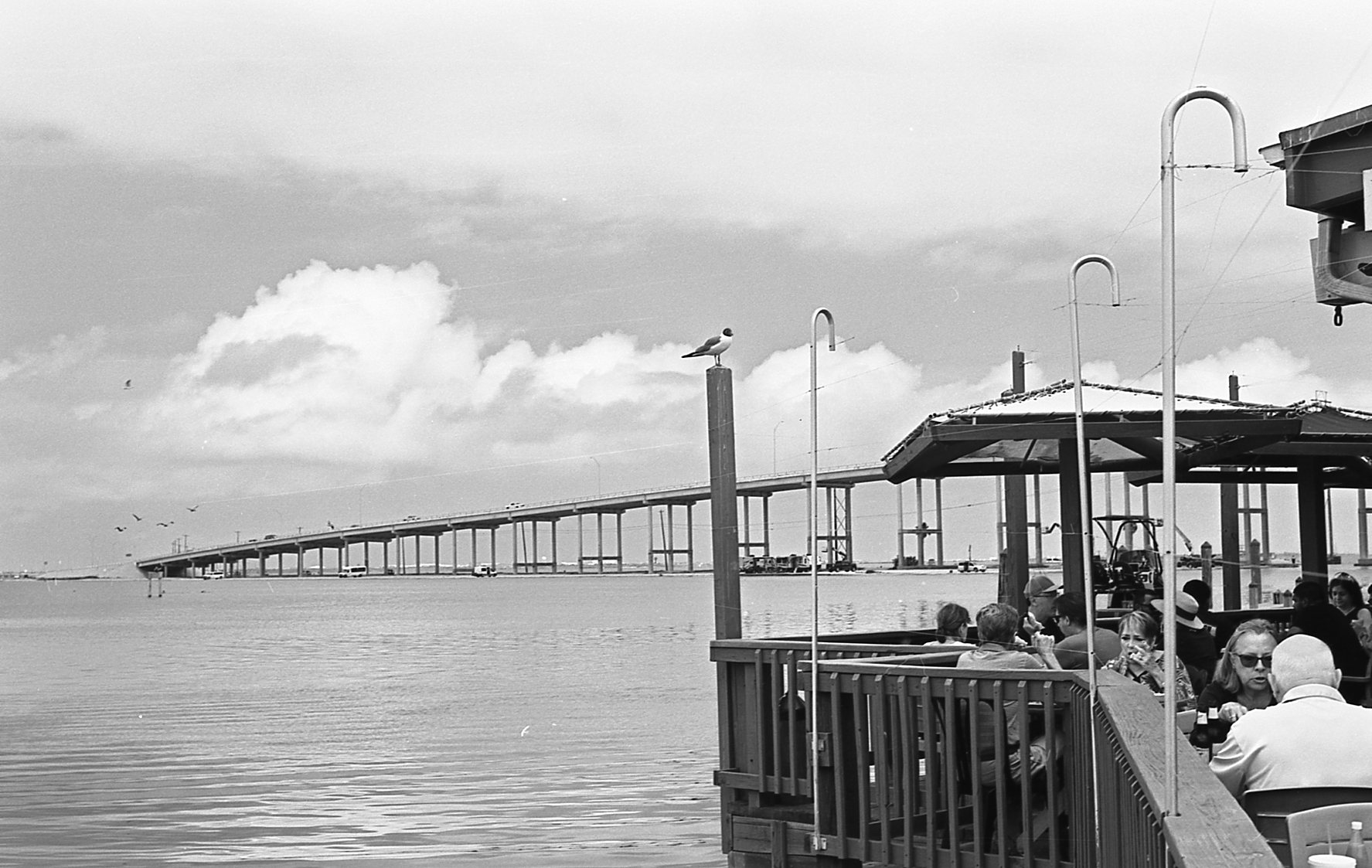

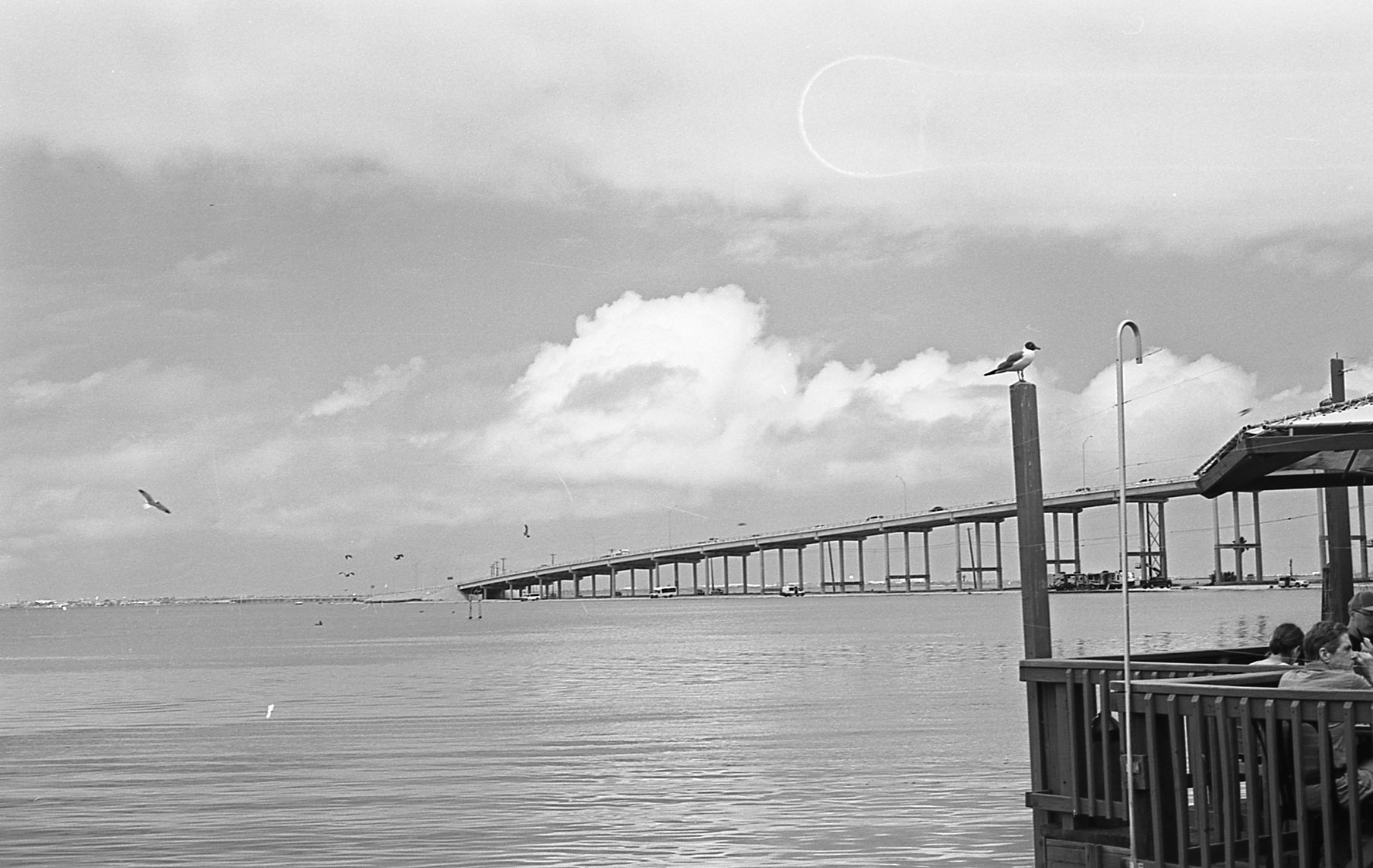

Can anyone tell me what the semi-circle is on the first shot and how to avoid it? I know it is not scanning dust because it appeared on another picture as well (not attached here) in a different spot. In both of those shots, the sun was directly overhead.
The filter and step up rings form a bit of a hood, but not a large one. Do you think it just a hood issue?
Thanks!

It may be the reflection of the front of the lens. The filter is fairly large and with the step up ring may have put it just far enough away from the lens to catch a reflection.

I can’t diagnose the issue. But it is a wonderful image! Where was it taken?

Looks like a drying drip - the negative got splashed with something that mostly dribbled off to the right. The semicircle is the outline of the original drop.
But, it being 'Silbera' it could be a "manufacturing enhancement" (can't say "defect", that's just not PC).

I agree with Nicholas that it looks like a drying mark and not like lens flare.
The common response at Photrio to diagnose problems is to ask for a picture of the negative itself (held up against a light source, like a white screen) in addition to a scan. In particular one question is whether the light lines extending to the right go beyond the edge of the frame.

My very first though at looking a the photo was "drying mark", and still is.

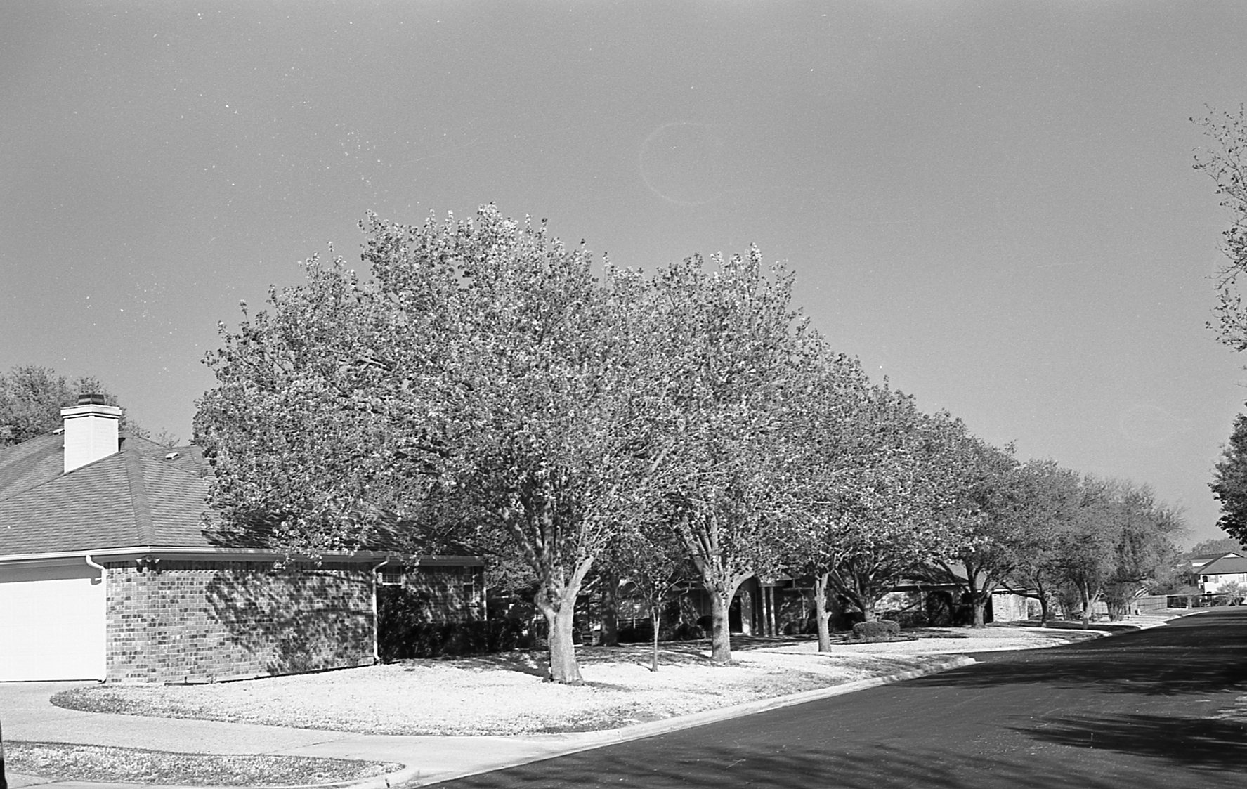

I used a Paterson squeegee and the flaw is very similar to another shot on the same roll, #32 below, where the sun was fairly low, behind me and to the right. This is my first roll of Silberra S25. As new as I am to developing I haven't seen this or any other drying issues (other than removable dust) on any other rolls of various types of non-Silberra film. This would seem to point to a film manufacturing issue or the reflection. Not on any of the other 30 or so shots on this roll, though. Thanks.
The lines do not go beyond the edge of the frame. I taped the negative to a white computer screen but my old Iphone6 just doesn't show the flaw, which can barely be seen with the naked eye. My digital SLR cameras do not focus close enough. How do capture the negative picture - better phone camera?!

I am using a plain laptop, but even there I can see to the right of your "semi-circle" that circle being closed and stretching further in two long, parallel lines. The whole thing looking like a sketch of a matchstick.
I cannot imagine how this could be an exposure.
I can neither explain it as coating defect.
For a drying mark it looks extremely regular, but still this is my explanation.
Further information could be gained from microscopic examination.

I looked at this scanned image on a much larger screen and I see the lines. So I think your explanation is correct. I used the Ilford wetting agent as the last step before the squeegee and hanging. Without the squeegee I probably would have had one circle at the final, because those lines are so straight it makes me think they are left by the squeegee. Just for the record, is there any way this would have cleared itself up had I not used a squeegee? Thanks.

This is a drying mark on the film, from a drop of wetting agent. You may have squeegeed your film, but its pretty obvious this is a water drying mark, so....

Could be a drying mark, but I've never seen one so round, those are usually irregular. Could be a reflection too. Sun in the frame? Didn't see that in that pic, but I can't tell where the sun is in it.
Are you hanging the film to dry? Seems unlikely that a drying mark would leave such a large, almost perfectly roundish drying mark if it was hung to dry.
