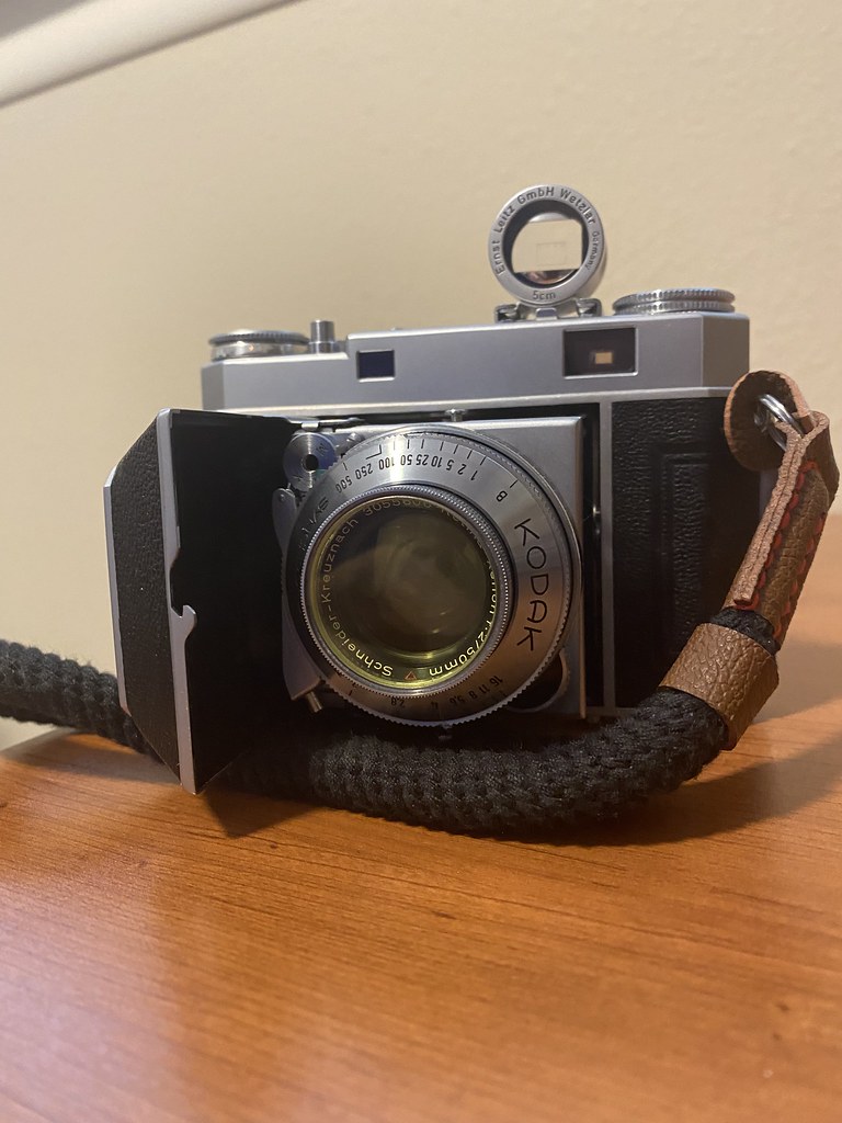

I've owned this IIa for a few years and enjoy using it. When it was serviced, the technician installed a plastic buffer on the eyepiece to keep it from scratching my glasses. It works well and the camera is easy to use but seeing the entire finder is problematic with my poor vision. I thought of adding an accessory viewfinder and found a SBOOI for a good price. I was curious if anyone is using this combinations. The finder will arrive in about a week, any suggestions are always appreciated.

The late Jim Hughes, of Camera 35 and Camera Arts magazines, promoted this setup in CA once or twice. Makes sense to me, as the VF in my IIa is small and dark.

Thank you and I was able to find a photo of him using the IIa with the SBOOI. I just processed the roll and couldn’t see enough difference in alignment between the viewfinder and the SBOOI so I’ll keep using it. The sports finder is fun to use and even has a distance adjustment.

An accessory finder that is displaced 2.5" from the centre line of a lens will give you a view that is displaced by 2.5" from the view seen by the lens.
For closeups, that is really important. For more distant subjects, that may hardly matter at all.

Considering the minimum focus is 2.5 feet and mostly I use it for subjects that are farther than arms length, it should be fine. The sports finder has a sliding view window for framing subjects from 3.5 feet to infinity with a notch at 6 and 15 feet. Between the two, I actually prefer the sports finder, it’s centered over the lens, folds flat and fits in a pocket without snagging like the SBOOI does.
