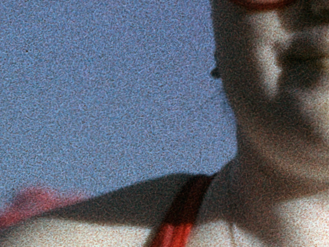

An irregularity for modern colour processes for sure, but of note is the terrible storage conditions of this roll.
This is the first time i've seen E6 reticulate.
I have processed dozens of E6 this way with the same kits and never had an issue, all chems and water washes are regulated at 38 degrees so there is no sharp temp shock beyond the pouring of the prewash.
Now because of the poor state of the film, a 4 stop over exposure and pull was needed to achieve a good Dmax in E6. So EI 12 was what was settled on.
The top row was C41, the base should be a clear blue tint.
Evident in this scanned colour corrected crop is the reticulation.
Any thoughts on cause would be valued.
Also, Ilford E6 colour kit was used for E6, Ilford C41 used for C41.
Both reticulated.

Not sure I understand where you think the reticulation occurred if all temps were at 38C. The first pour?
In this case it doesn't really look much worse than increased presence of grain so I think I'd be happy with the results from such an old film in 35mm.

The issue is that I don't know why the reticulation is occuring. I suggest the first pour as that is the only time a temp shock could be interpreted.
Yes it is fairly minor but is unideal especially for enlarging.
Trichromes don't allow for me to enlarge without pin registration and I don't have anything like that.

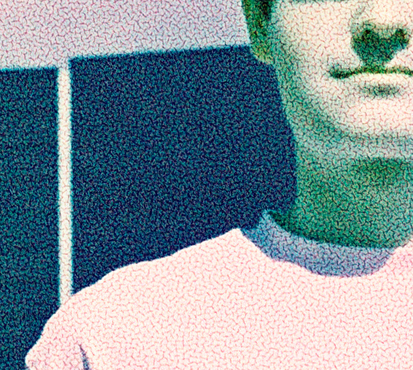

No stop bath is used in either process.
here is a scan of the film from top row, C41 processing
Reticulation is far more visible in negative processing but is evident in both
That's definitely reticulation or an effect that's physically very similar.
My thought would be that the subbing layer that binds the emulsion to the film base has partially failed/weakened over time, causing in the emulsion basically dislodging slightly during wet processing.
How old is this film? As I understand, subbing procedures/concepts changed in the 1990s especially, both at Kodak and Fuji. Pre-1990s film might be (far) more susceptible to this kind of damage.
It's interesting, I've never seen this on any relatively modern film. Nice example.
Maybe @FredK could add some insight on the failed-subbing hypothesis.
I've been able to confirm that this roll is from 2003 so what you describe should've been improved upon by then.
Reticulation due to age itself is very uncommon, and looking at unprocessed emulsion it doesn't have the cracked shimmer the processed film takes on
