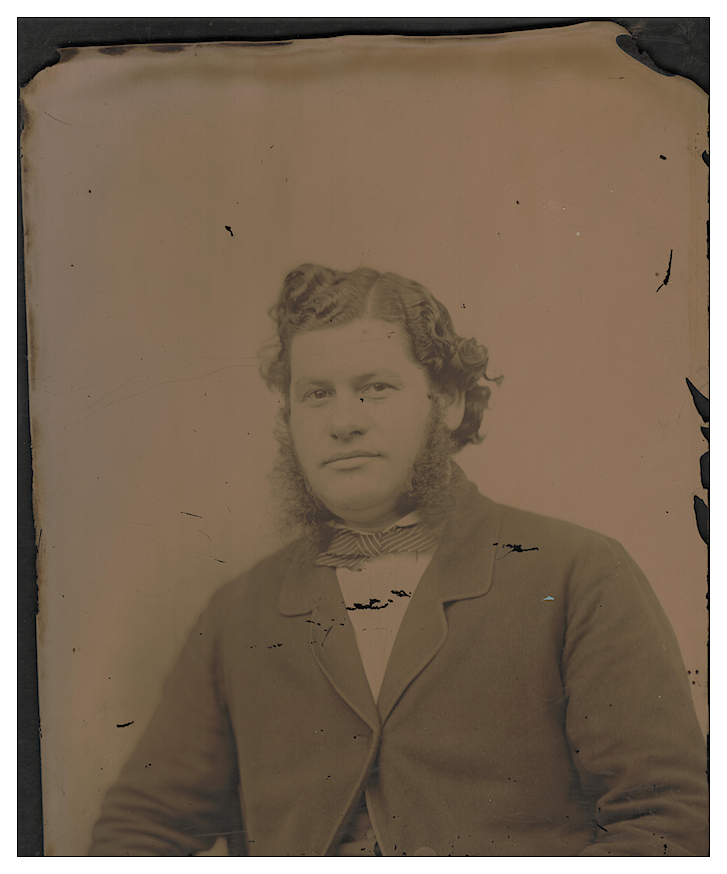

Making a digital copy is a good idea even if you get good advice on how best to conserve the original negatives. It's quite challenging to keep the feel of a vintage photo in a digital image, but you gain controls to correct fading, retouch blemishes, etc. Editing out the evidence of antiquity will seem sacrilegious to some folk, but it can really make the image come to life again. This example (one of my ancestors!) is from a glass plate negative scanned on a domestic flatbed printer/scanner. I haven't finished retouching yet.
