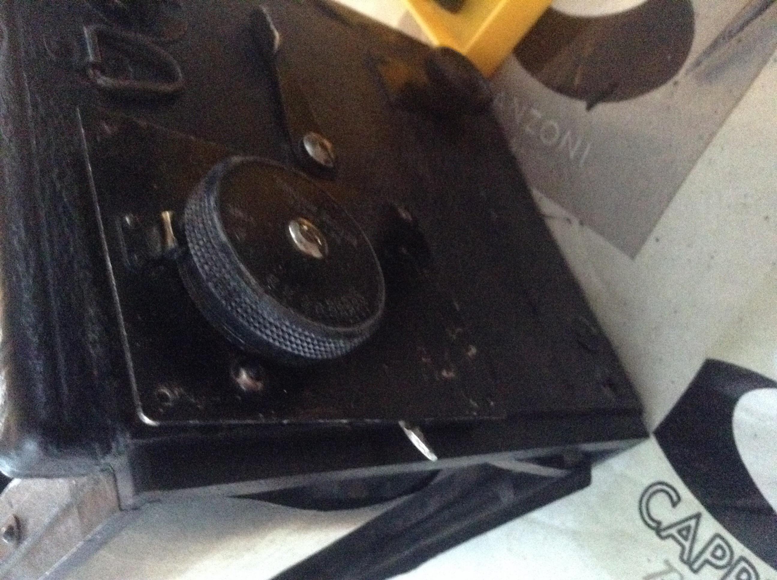

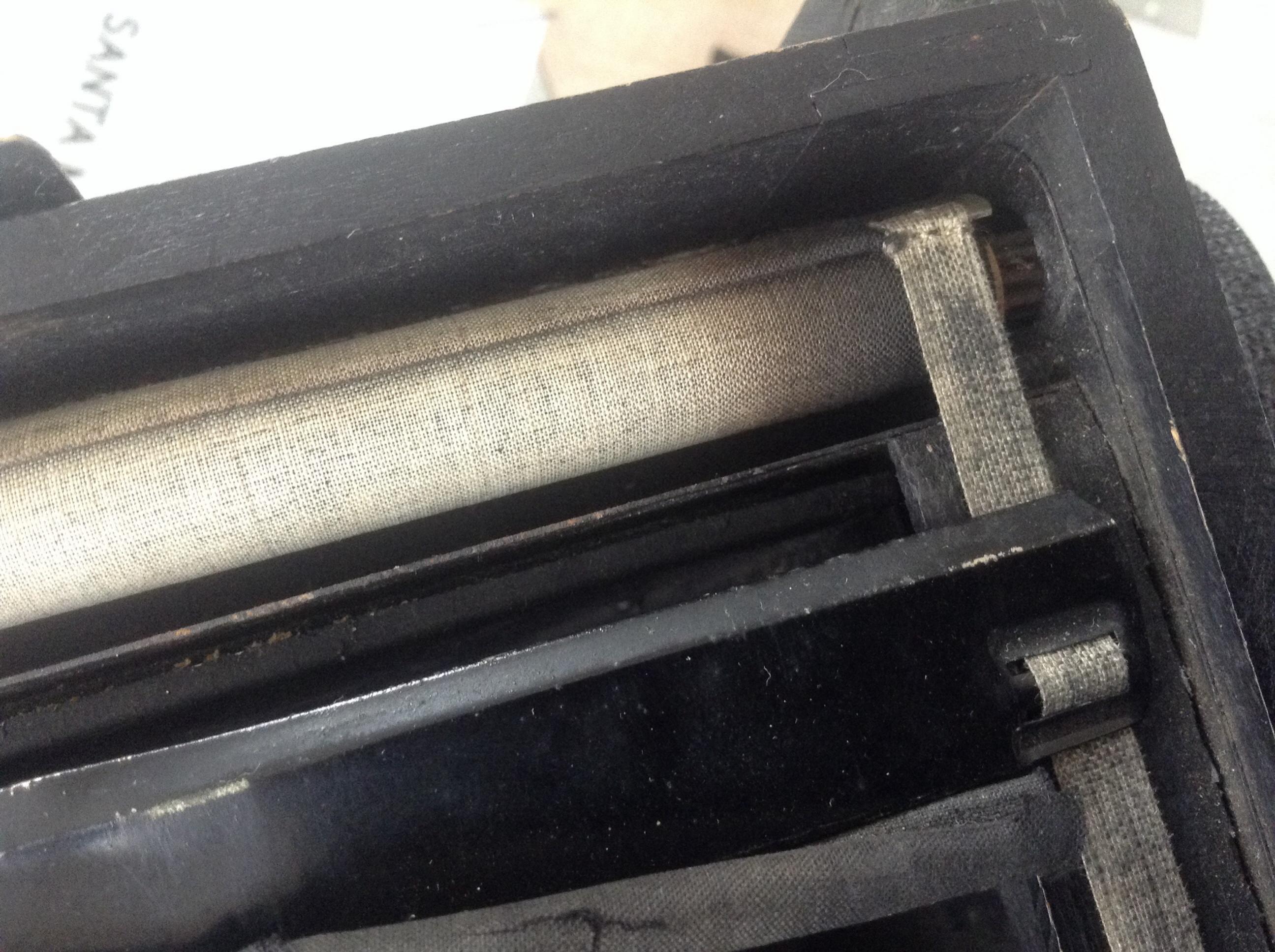

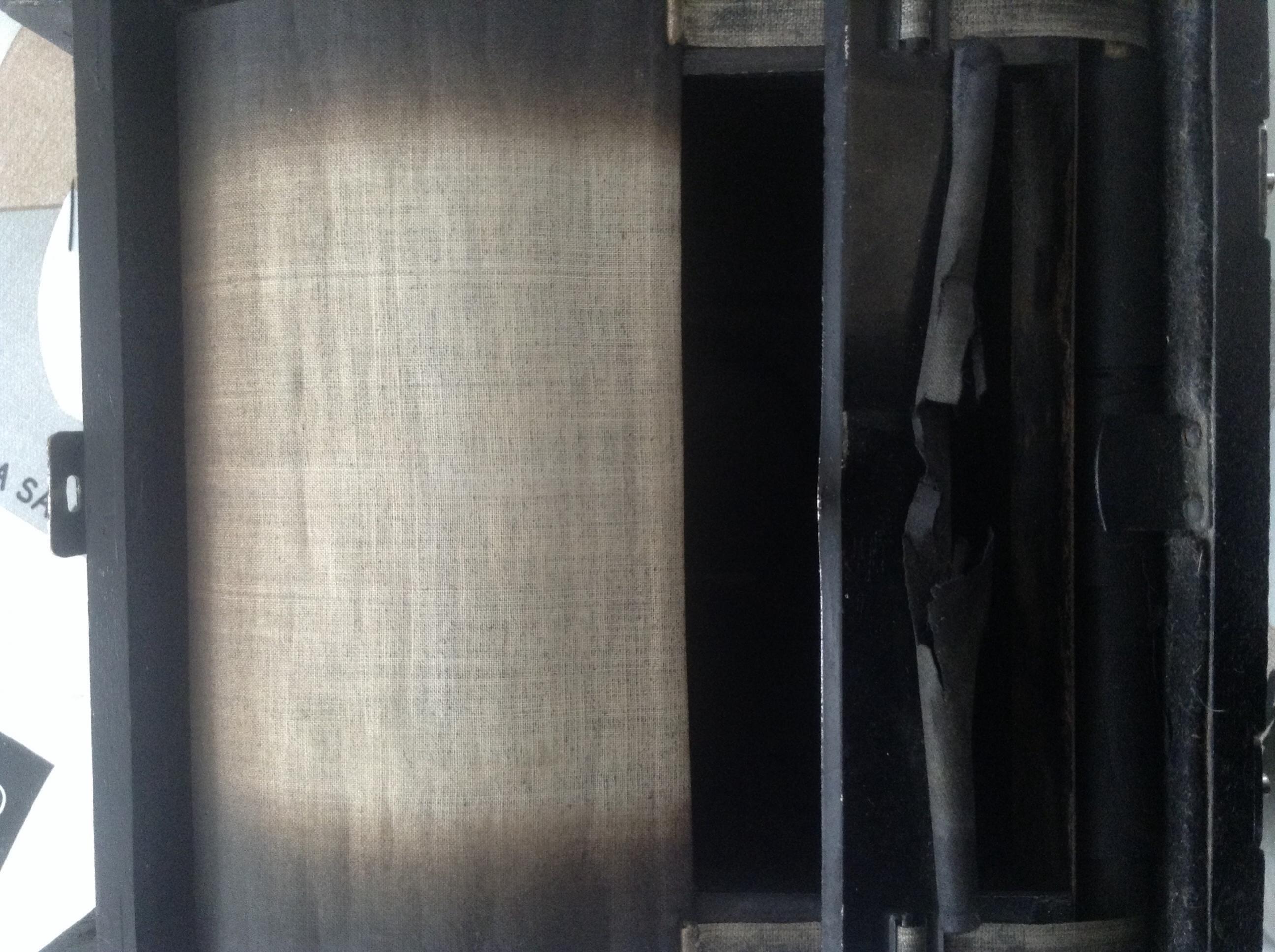

A few weeks ago I purchased what has become my favourite camera in my collection, the Ensign Special Press Reflex. The seller described this rugged beauty as being in a non working condition and in need of total restoration. So far I have really only cleaned the mirror and given some parts a light oiling. However I need some help in repairing the focal plane shutter as it appears to have deteriorated and is crumbling, any help would be greatly appreciated and I will be attaching photos in my next post.

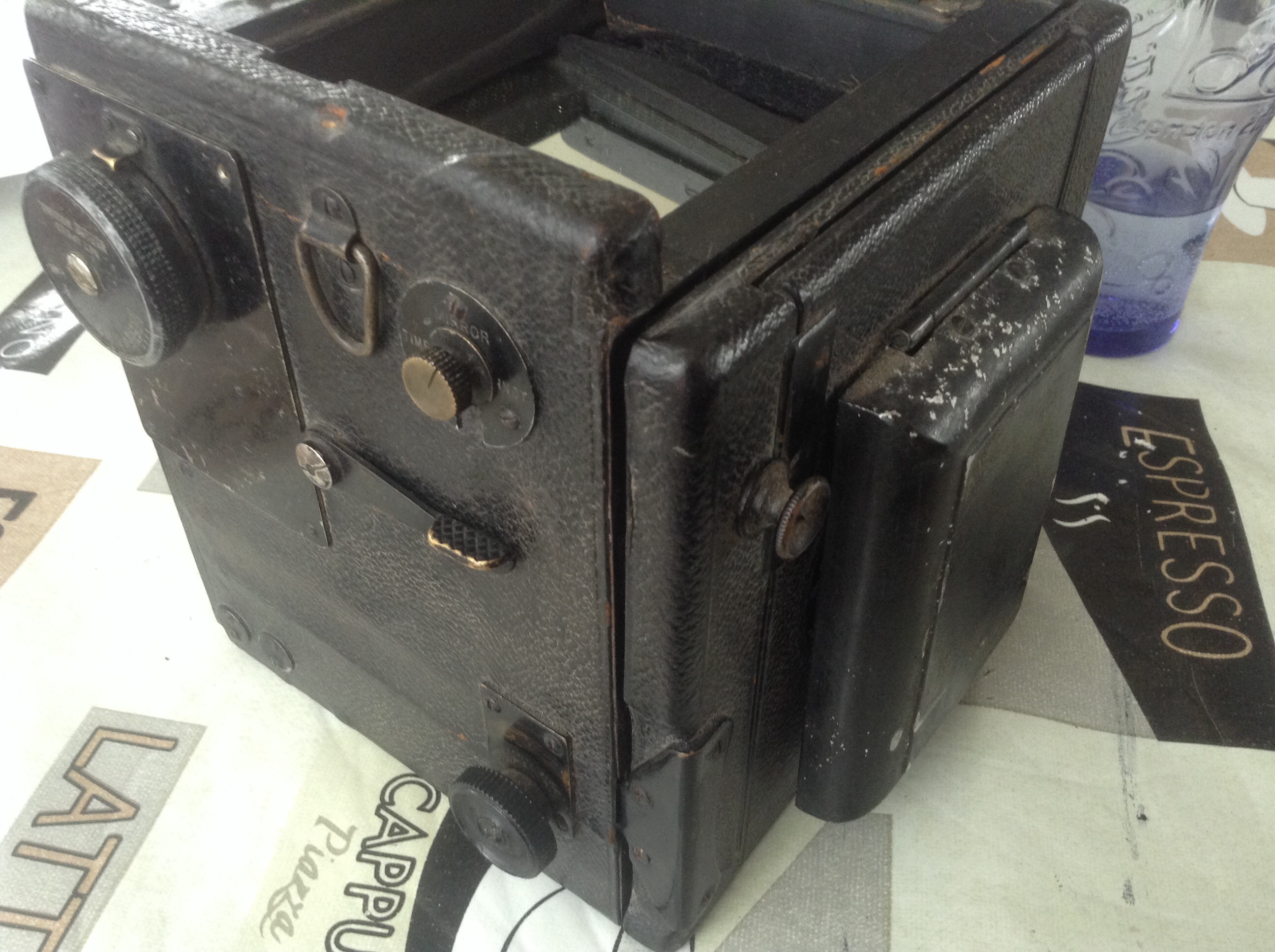

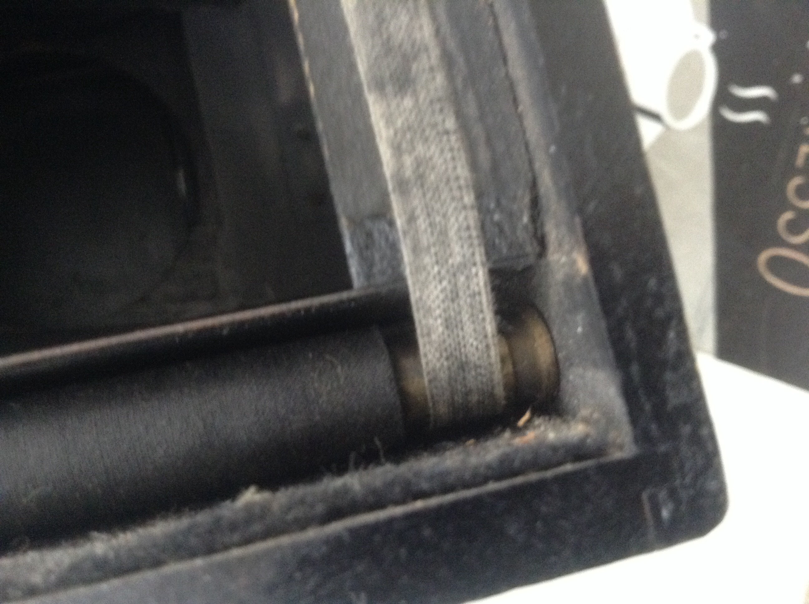

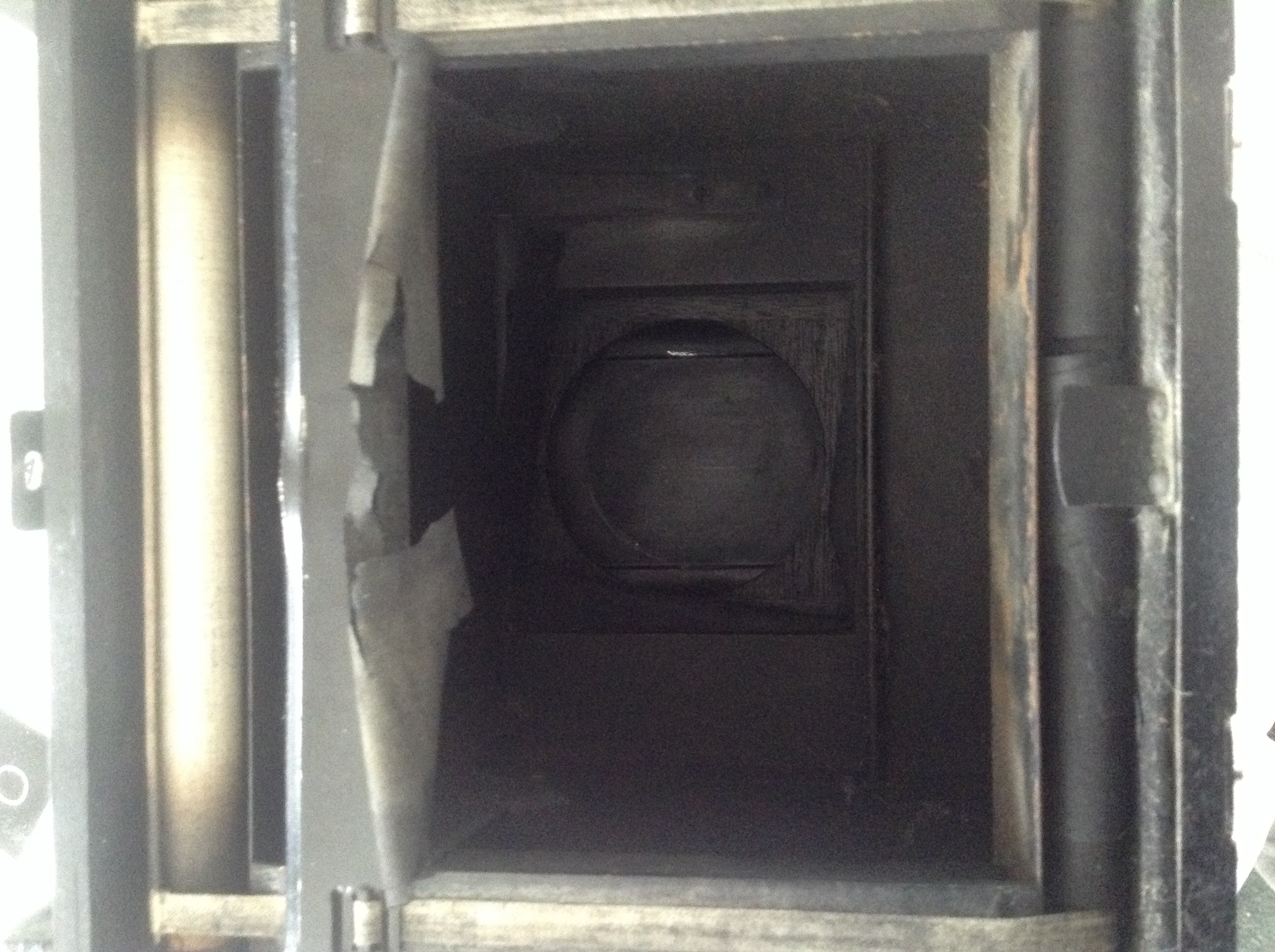

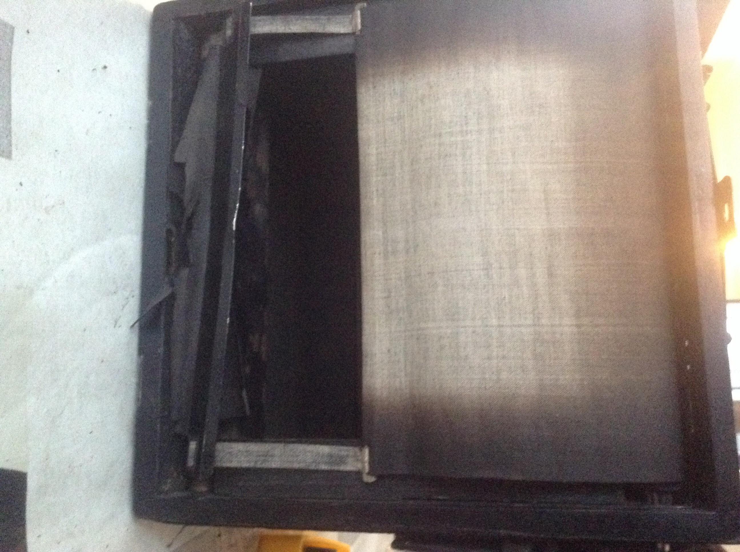

Pictures of my Ensign Special Press Reflex

So I have begun the process of restoring my camera. So far I have started removing the exterior fittings such as the shutter speed control dial and the parts that hold what used to be the hand strap.
I have decided that this project is going to be a full restoration as opposed to a localised repair of the shutter:smile:

Curtain roller shafts wear to their support bushings, swapping top with bottom may make the shutter run slow. Excessive wear on the roller shaft or its bushing can be somewhat corrected by adding shim stock to the bushing or in severe cases sleeve the bushing. Graflex FPS require .002 to .003 inch clearance between the roller shaft and the support bushing to run properly. The adjustment plate end rarely wears.
The aperture stays are usually copper, .010 to .020 inch thick, and can be opened with a 1 inch wood chisel pressed into the gap where the curtain is/was. The stay can be crimped onto new curtain material with the flat section of needle nose pliers.
Knobs and dials of that era were attached with taper pins, large end usually at the top so they are driven out from the bottom. Some seize into the shaft/knob and require a day or more in penetrating oil to come out.
Straight on pictures are usually best for camera part pictures, side angle pictures hide details and distort the assembly.

From your pictures there appears to be 2 controls for the shutter, I cannot read the information on their plates. The large one has Time and speeds and the smaller one ?

The smaller knob controls the mirror and has nothing to do with the shutter, the small knob has Time, Mirror and Instantaneous settings. Time is to keep it open during time exposure, mirror keeps the mirror locked in the up position and Instantaneous puts the mirror up at the start of the exposure and releases it at the end
