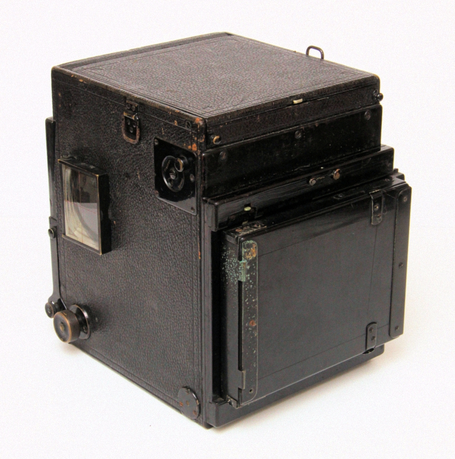

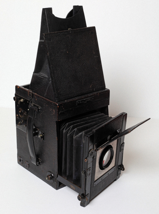

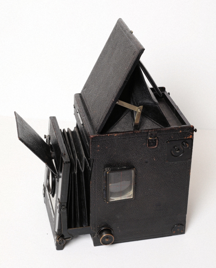

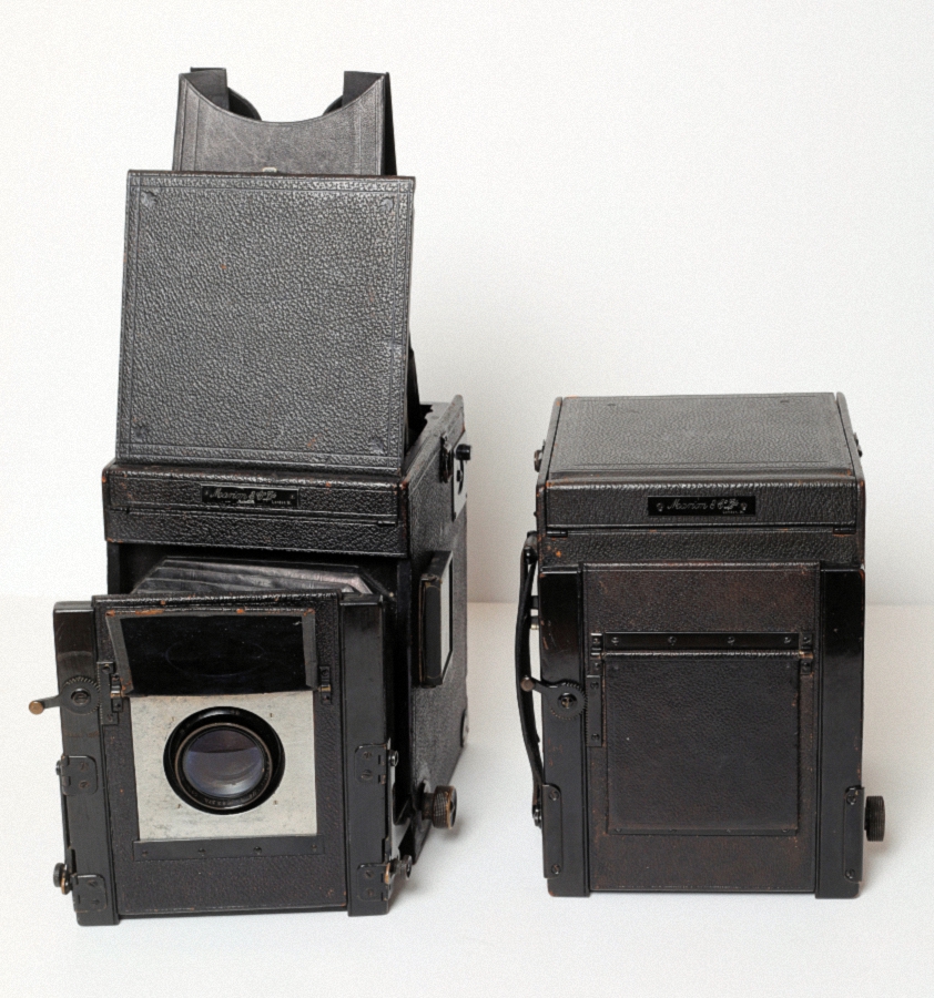

Some photos, the first Marion Soho Reflex with Cooke-Butcher lens, showing the movements.

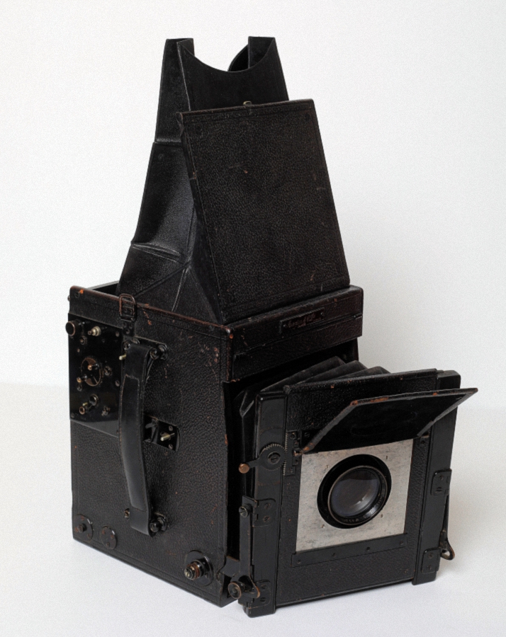

With the second.

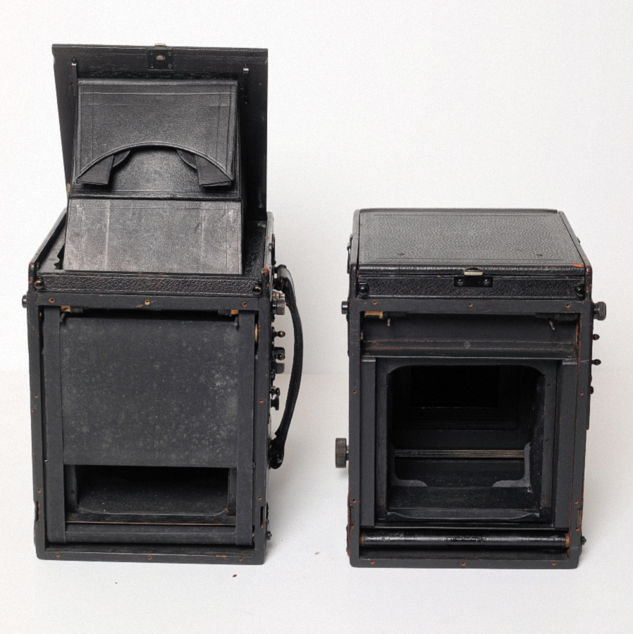

The shutters
I have the curtains and top roller for the second Soho Reflex, but I'll replace them, the ribbons are lost.

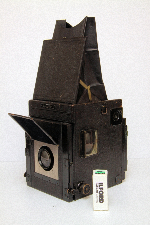

For scale alongside a roll of 120 Delta 400.
I've got some other cameras t finish off first.
