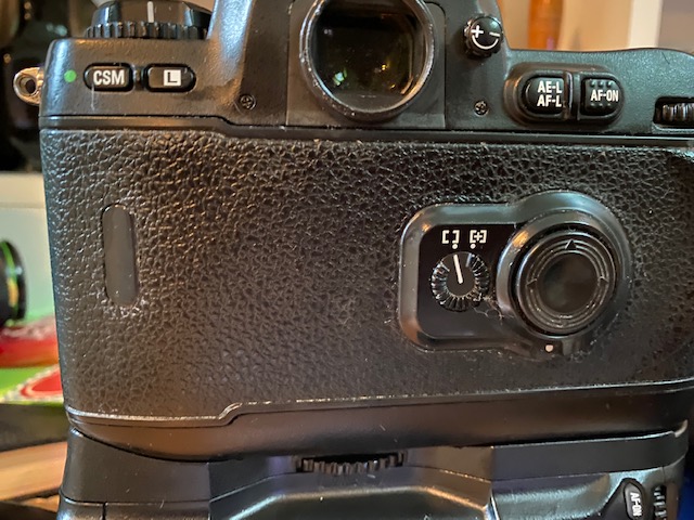

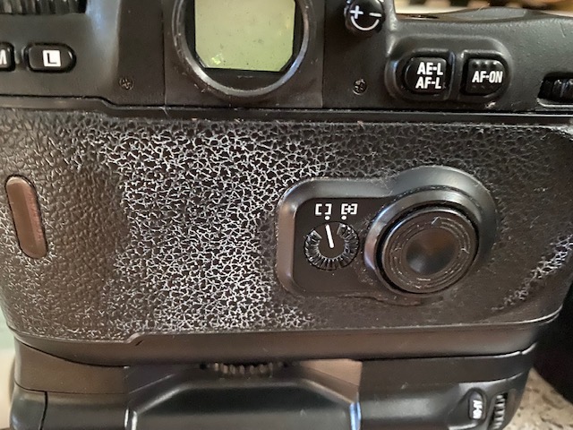

My new F100 works great, but may have been cleaned a little too aggressively. Should I try regular Armorall, a specialized plastic rejuvenator, or something homebrew to restore the finish here?

I haven't seen that whitening on Nikons before. It's very common on early Minolta Maxxum cameras and lenses. ArmorAll works well on those. Sometimes you have to let it soak in.
Maybe your Nikon skin has been dried out with solvents? I would try ArmorAll to see how that works.

I’m thinking lots of rubbing alcohol caused the damage, but who knows. Glad to know ArmorAll will work. :D

That looks like the result of someone trying to remove sticky back syndrome. Looks like they used Naptha or Zippo lighter fluid. Alcohol isn't destructive like that. I used it on my F100 to good effect without any whitening. If all else fails get a scrapper camera and switch backs.

Thanks. It’s definitely not sticky, but this is to be my beater, so looks are less critical. I have another F100 in nearly pristine condition and used alcohol on it with no problems. I’ll pick up some AA today.

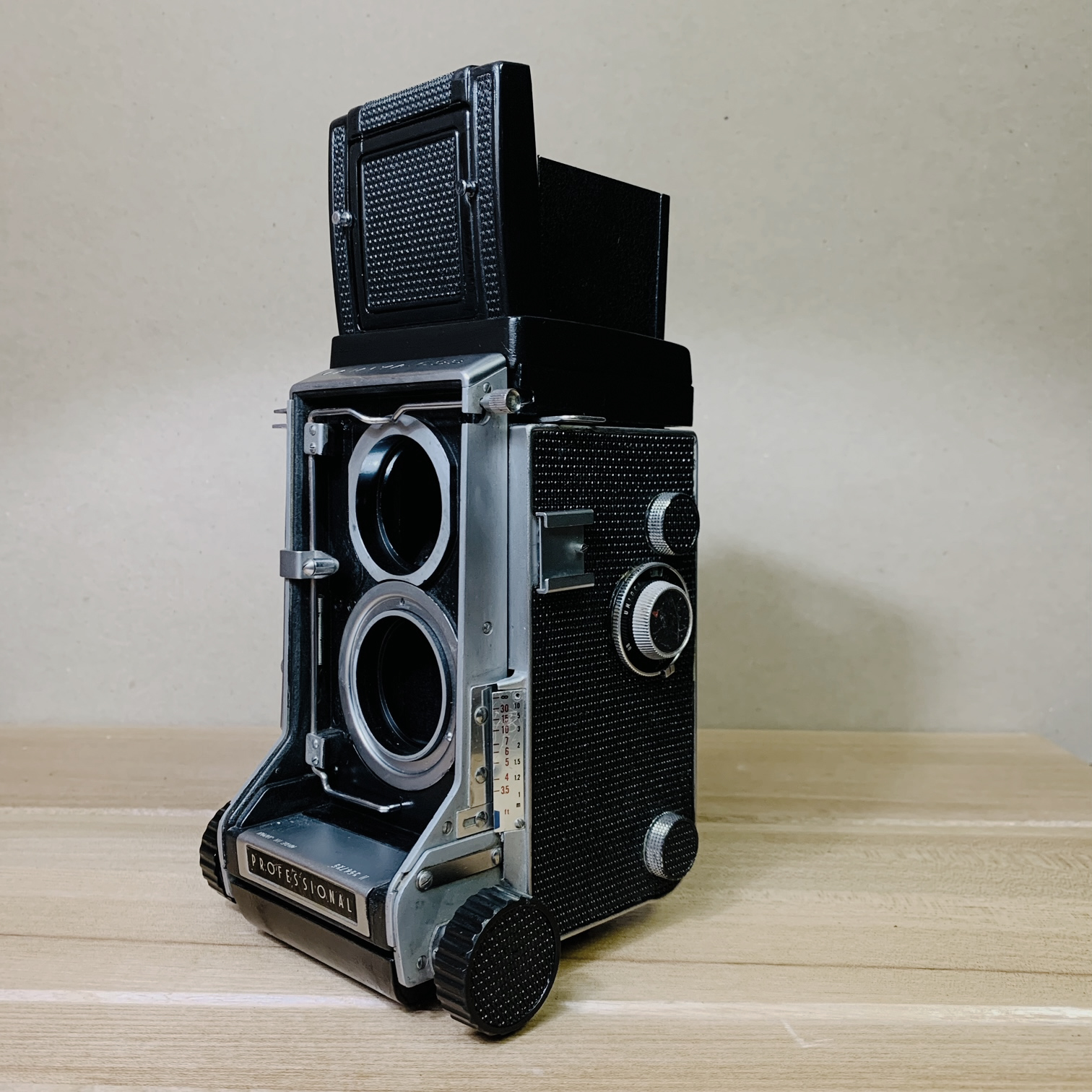

I restore lots of cameras. Ive had many that have had faded leatherette. The car stuff is just going to
come off at some point. I Use Americana Gloss Enamels Acrylic paint. You can get it online. I buy
it at Joann Fabrics. Not sure if they have that store in South Carolina. You also need to get a small
angled brush from there too. I have a whole set of different sizes...Lightly paint it..
Don't cake it on or it could become sticky.. ..let it dry overnight...
Heres a Mamiya C33 (before and after)..I just painted last night....

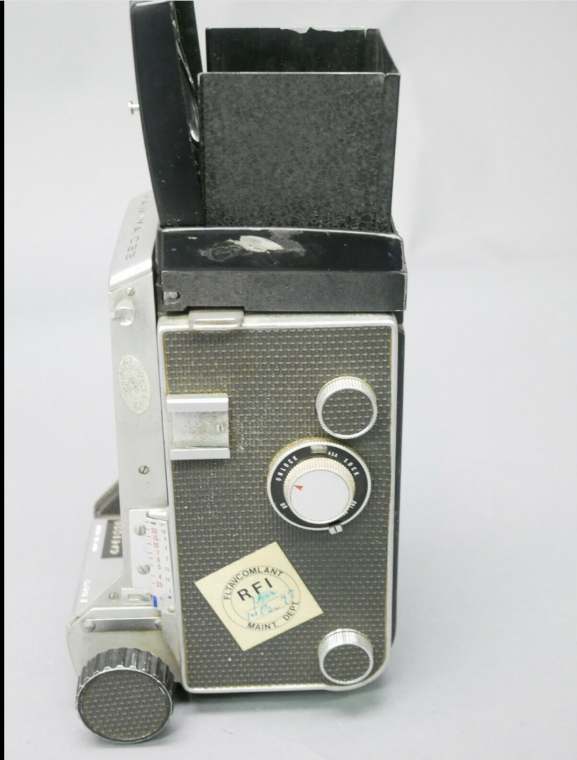

View attachment 278059 View attachment 278060 View attachment 278061
The C33 was originally gray, not black....

Where the fading happened is not Plastic.. Its a faux leatherette with an adhesive back that
is applied over the plastic. When I restore my cameras, I usually either repaint that part or pull it
off and put new leatherette on it.. You can buy black faux leatherette in a roll... But in the case
of your camera. I would just repaint the leatherette part with black acrylic paint as I shown in my
previous post....
Armour All is not good to put on camera gear and its just going to come off at some point anyway...
