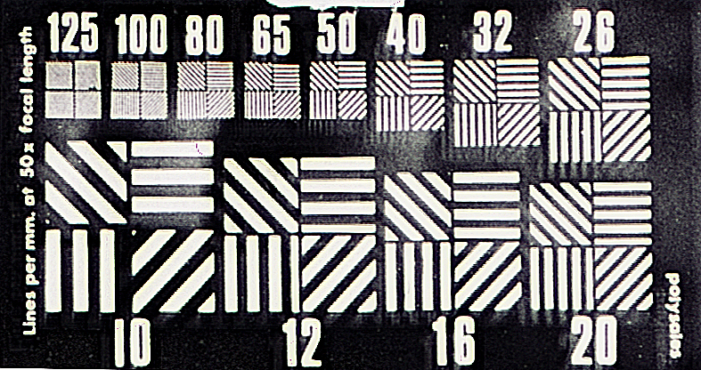

I photographed a test chart using a Canon 50mm f1.8 at f8 lit by off camera flash, at the correct distance (50x focal length).
Film was Ilford Delta 100, developed in Rodinal 1:50 . The chart was at the center of the frame.
A negative of the chart was scanned at 7200 dpi in the Plustek 8100 and as normal, black and white levels set and sharpening applied.
IMO the resolution read off the scan (attachment) is ~80 lppm
This corresponds to 80x2x25.4= 4064 dpi.
This is higher than the more reliable result obtained at scandig.com of 3600 dpi, probably because my reading of 80 is a bit optimistic.

I agree with you that 80 lppm is adequately resolved, in this high contrast target.
Overall this seems to me an excellent performance.
I was worried about the health of my expensive Nikon LS-5000, which has a 4000 dpi resolution in real terms.
I am glad to hear that a replacement would be not very expensive.
Thanks for sharing.

Your results seems to far exceed scandig's. You're using a DIY test frame on Delta 100 while scandig uses a commercially bought test target. Have you tried scanning your target with any other scanner covered by scandig to corroborate your results?
Jul 31, 2012
3,316
The only problem i see here is that you are filtering your results through a lens, so your scanner may in fact be able to resolve more than your result. Or your lens may resolve more than the scanner. Hard to tell. At any rate, it is good enough!

Under my old Lomo microscope I examined the negative of the very same test chart as shown in the original post above.
By this means it could be seen that 100 lppm (but not 125 lppm) is visible on the negative, though only somewhat less than 80 lppm was resolved by the scanner.

Also I stated the Scandig result more likely to be accurate.
Here too I regard the Scandig result as more reliable.
Why would you say that scandig's results are more accurate and reliable? If so this obviously makes your results less accurate and less reliable.
It seems to me you are using different standards and therefore to correlate your results with scandig's a mathematical factor may have to be applied. This works well since both of your results are higher then scandig's. The more scanners you test with the same higher results will validate your standards and procedures.

filmscanner.info has the PlusTek 8100's resolution at 3800, so the OP's findings are in the ball park.

I obtained a higher resolution from this scanner using Adox CMS document film developed in TDLC-103 (Film Developing Cookbook formula).
With this 100 lppm is nearly reached.
I’d say 100 is clearly reached.

Before the digital era things were well defined as indicated here:
https://www.image-engineering.de/library/technotes/761-resolution-measurement-and-its-units
Now I believe various different methods are used , some mentioned in the conversion table but my knowledge of this is limited.
I did need to increase the contrast to demonstrate 100 lppm on Adox CMS20 so this may be on the optimistic side for pictorial photography.
If the line pair is there it’s there.
Increasing contrast and sharpening is not cheating, it’s part of image processing.
