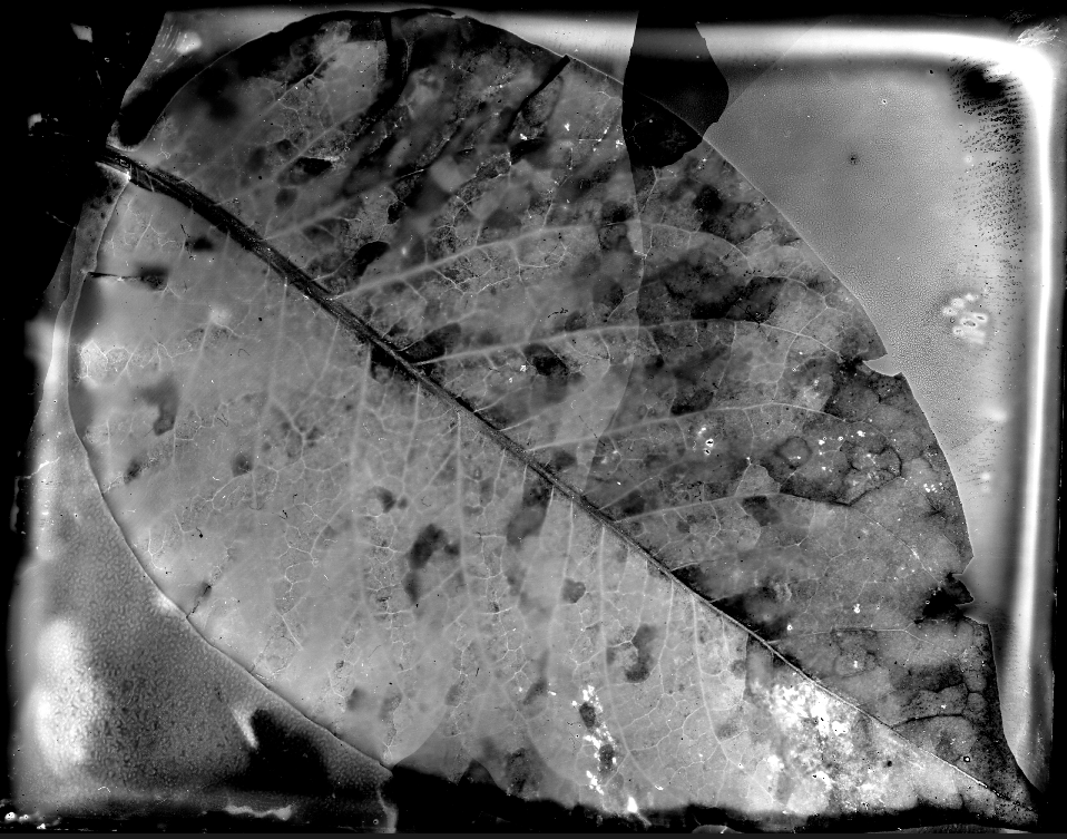

Well, my plates aren't that old. They're Kodak ortho plates made about 60 years ago (yeah, not that old). They've been opened to daylight so they develop out max density. I was stupid enough to buy them. The plate I messed with this morning, developed, bleached, developed, bleached again, developed again - bleached one last time. Every redevelopment (even though exposed to more light), less development occurred. So, I contact printed a leaf on it under a 150 watt bulb for about 2 hours. I dunked it in developer for a few seconds and then fixed it. Very very thin negative. I should have left it longer in the developer. Not sure anything more would have happened, though.
Quite pretty; I like it.
I would also say "impossible to enlarge". This is one of those things that can be seen by a scanner and virtually disappears when you shine light through it.
Next time, I won't get my thumb- or fingerprint on it. Maybe. The emulsion was pretty soft after being cooked under 150 watts for 2 hours.
So, what happens? I developed the fully exposed plate, bleached it. When I redeveloped it, it developed more slowly and didn't get as dense as it did before. That was true of the next time, also. The last time I developed the plate, it turned a grey the colour of cigarette ash. Why was it not redeveloping back to fully black?
IDK, but it matches experiences I've had from time to time torturing silver halide emulsions with repeated bleaching etc. Once it starts going south for some reason, things get Antarctic pretty badly.
