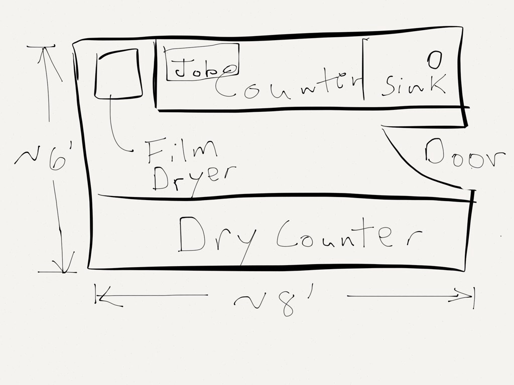

Ditto to a quick drawing. That being said and no mention of a need for an enlarger/sink for processing prints, you aren't going to need much space and the layout will probably be pretty simple. Bill "With Too Small a Darkroom" Barber
On a larger perspective, you either build an enclosed dark area in the basement or you treat the windows and stairwell such that they will be light tight. I have constructed darkrooms that use both strategies.

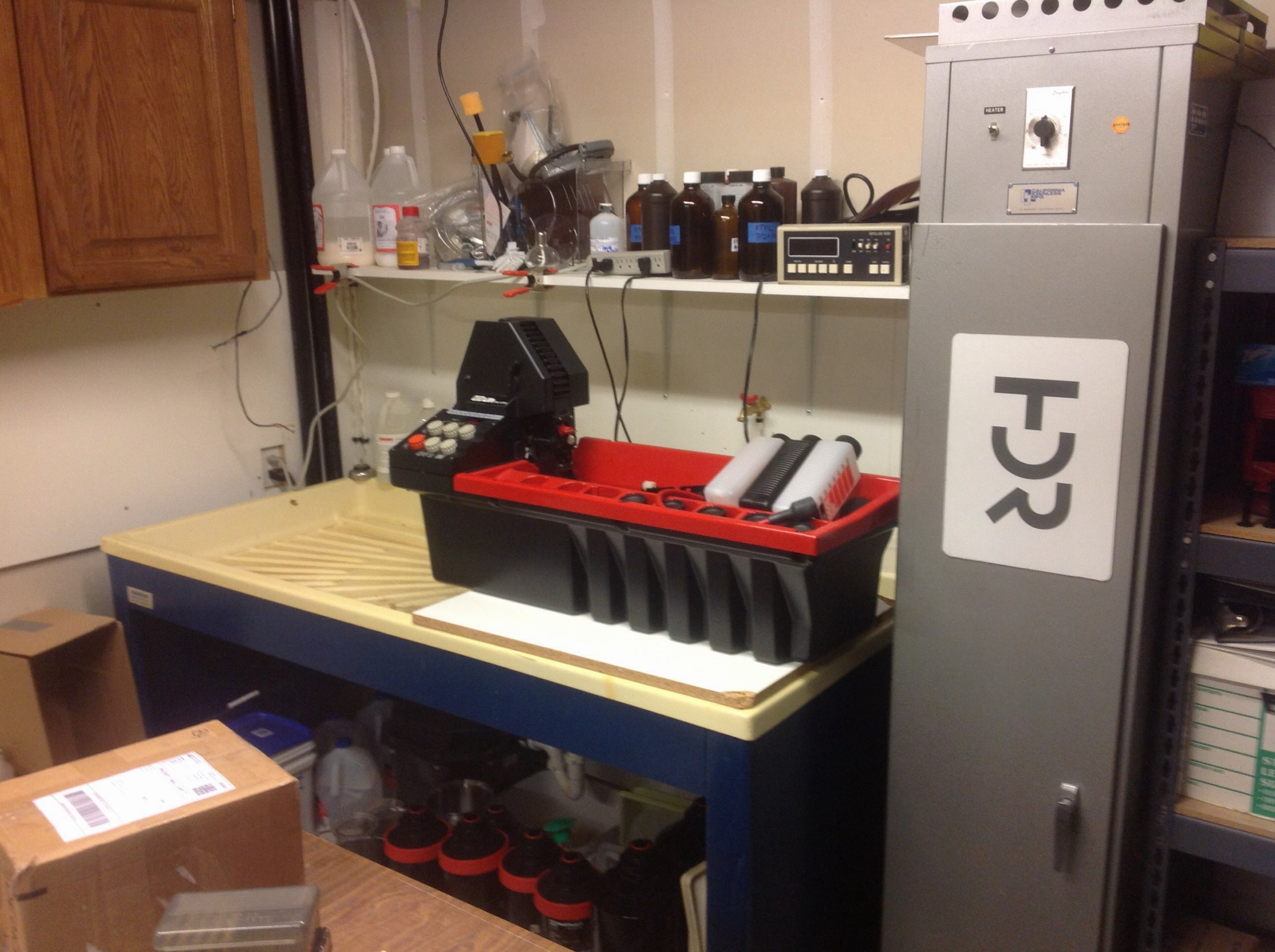

The attached sketch is the initial thought regarding a layout and the photo shows my current corner of the basement. The sink is 3'x6' and is much larger than I need.

Water supply and drainage are the usual constraints on what goes where as they are more difficult to install. Power is usually easy to put where you want it. If you are doing wet plate, I would give special thought to ventilation. And maybe a proper flammables cabinet.
Check how your Jobo drains. My smaller CPE2 likes to drain on the left. The CPP may be more flexible in that regard - I am not familiar with it.

The vicinity of the basement that I have to work within does not have sewer and water readily available, so I've installed a sink sump and pump unit (photo below) and routed water there using PEX pipe.
The Jobo CPP also drains on the left. For a reason unknown to me, I think (feel) that I would like the sink to be to the right of the CPP processor - have no idea why I think that. If someone has an explanation why or has experience that confirms or refutes this, that input is invited. I could easily put a drain cup in the counter to drain the Jobo.

Most people like to work left to right (at least Western right-handers). I had to extend the drain pipe on my CPE-2, but putting in a drain point is something I have been considering.
