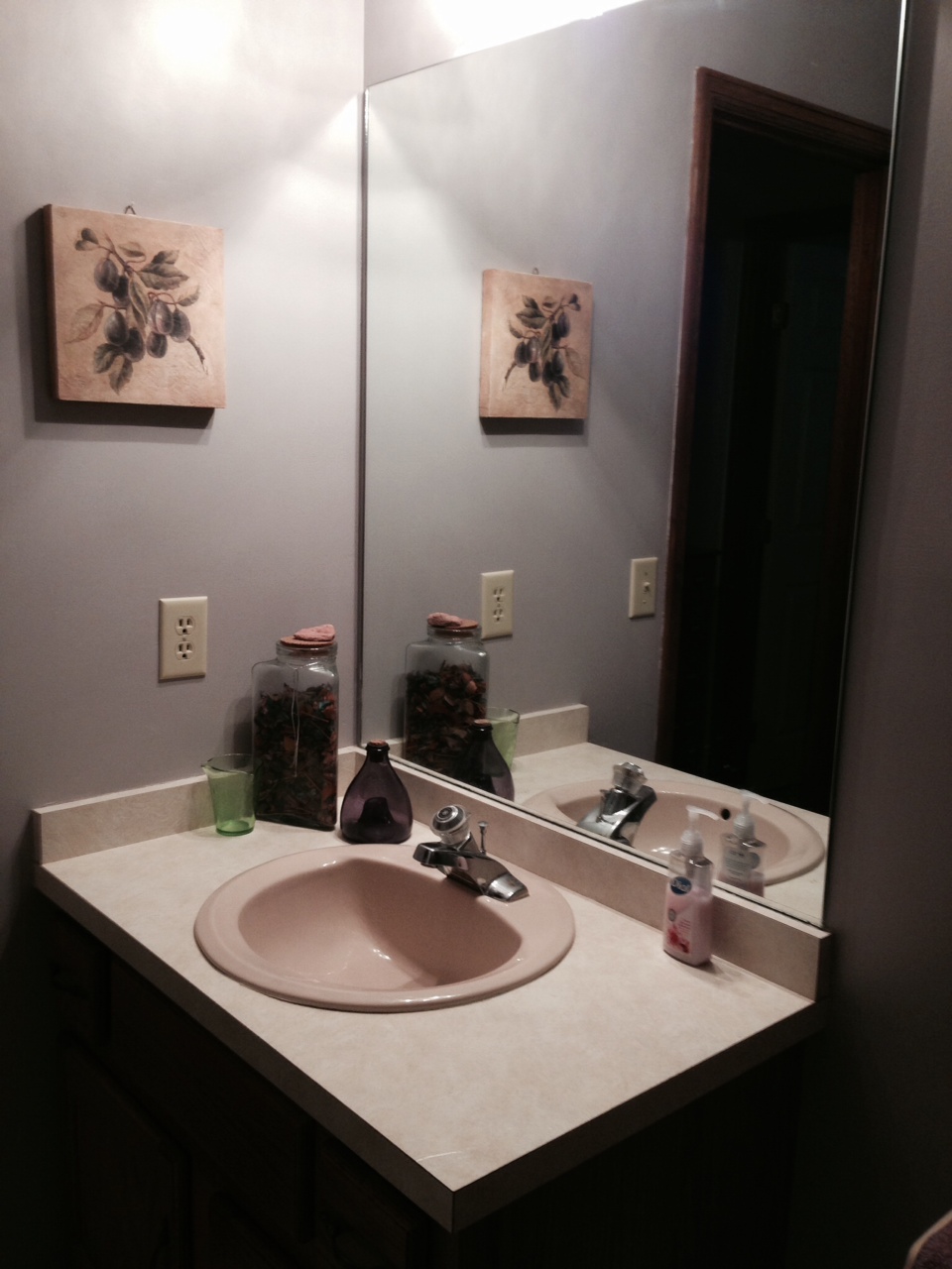

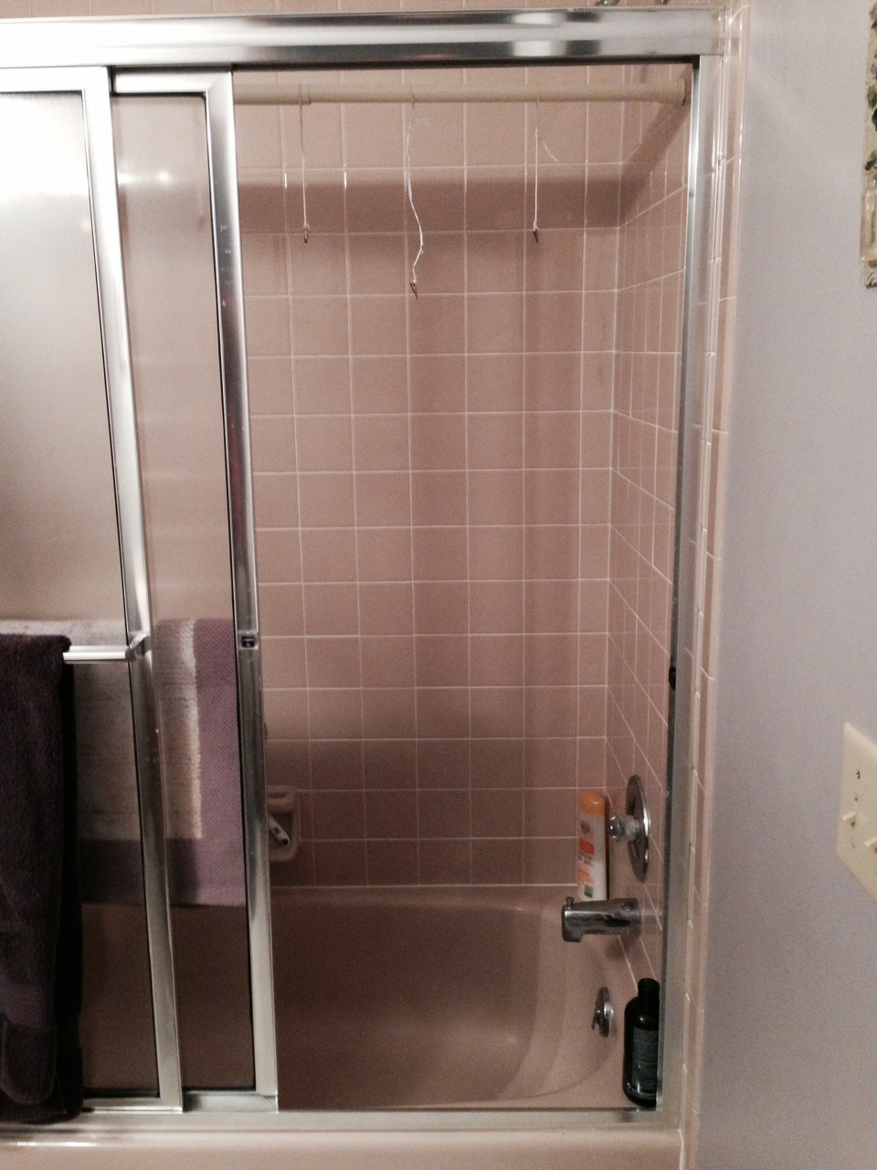

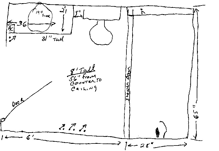

Bathroom images and measurements
8' ceilings
6' from door to shower doors. Shower 28" wide
65" wide room
Vanity 31" high
56" from Vanity to ceiling Sink extends above vanity by 1.5"
Vanity is 36" by 21" (standard 2 door kind)
Commode 9" from (tank lid) the vanity. 7" to the shower doors.
Three switches on long wall, Fan, White Light, Heat Lamp (I can see where the safe light goes)
One room switch left of vanity for lights above the mirror not seen
1 AC socket left of vanity as well, it is seen.
Inside the shower you will see an extra curtain rod with clips hanging. I already do tank processing of film in there and hang in the shower to dry.
Photos attached and a very iffy room drawing. Sorry for the lack of image quality, they are from the cell phone and there was a fog hanging in the room.

my method won't work with the glass shower screen, you wouldn't be able to reach in easily. Some kind of tray stacker might be the go.
