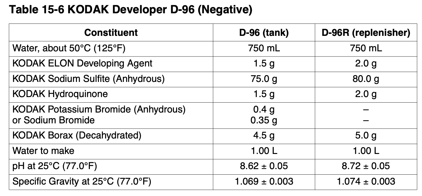

Yep, with film the main development byproduct of concern is probably bromide ion. I don't personally have too much experience with B&W materials in this respect, but my understanding, via literature, is that Metol is only moderately affected by bromide ion. So I would guess that this is a main reason why D-23 replenishment works as well as it does.
The ideal developer, if designed for replenishment, would already include a significant amount of bromide in the formula. This would allow a special replenisher - one with essentially NO bromide in it - to dilute the used developer (with additional bromide added as a development byproduct) back down to the original bromide concentration. This is, in fact, how the C-41 (color negative) process works.
