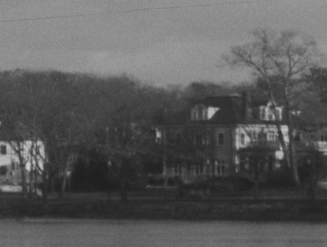

I did try it out, actually. Not great results, though it's entirely possible that infinity focus is set badly. I figured shooting at f/45 might alleviate potential issues with that, but who knows. Of the three shots I managed, one was triple-exposed and another had bad camera shake (I don't have a blow tube for that shutter), so it could have been my fault! Here's a crop from the center:

I love the neighborhood but a bit surprised by the quality of the picture. What lens is that?
Also, check which aperture system your shutter is using. My FPK is marked in US stops, not f/stop.

Yeah, I have it closed down all the way, and even though it's not marked (the last mark is 128 but the lever goes a bit beyond that) I'm guessing it's around f/45. The lens actually looks clear too, but the rear element is a bit iffy. I am going to try to calibrate infinity focus at some point and then give it another shot, but I have my doubts.

The lens needs to be pulled into the right place onto the focus standard as well-- maybe the whole works got moved one way or another. I have 2 Ansco 3a equivalents, and their lenses (Ilex 7", IIRC) are decently sharp, but camera shake is an issue.
