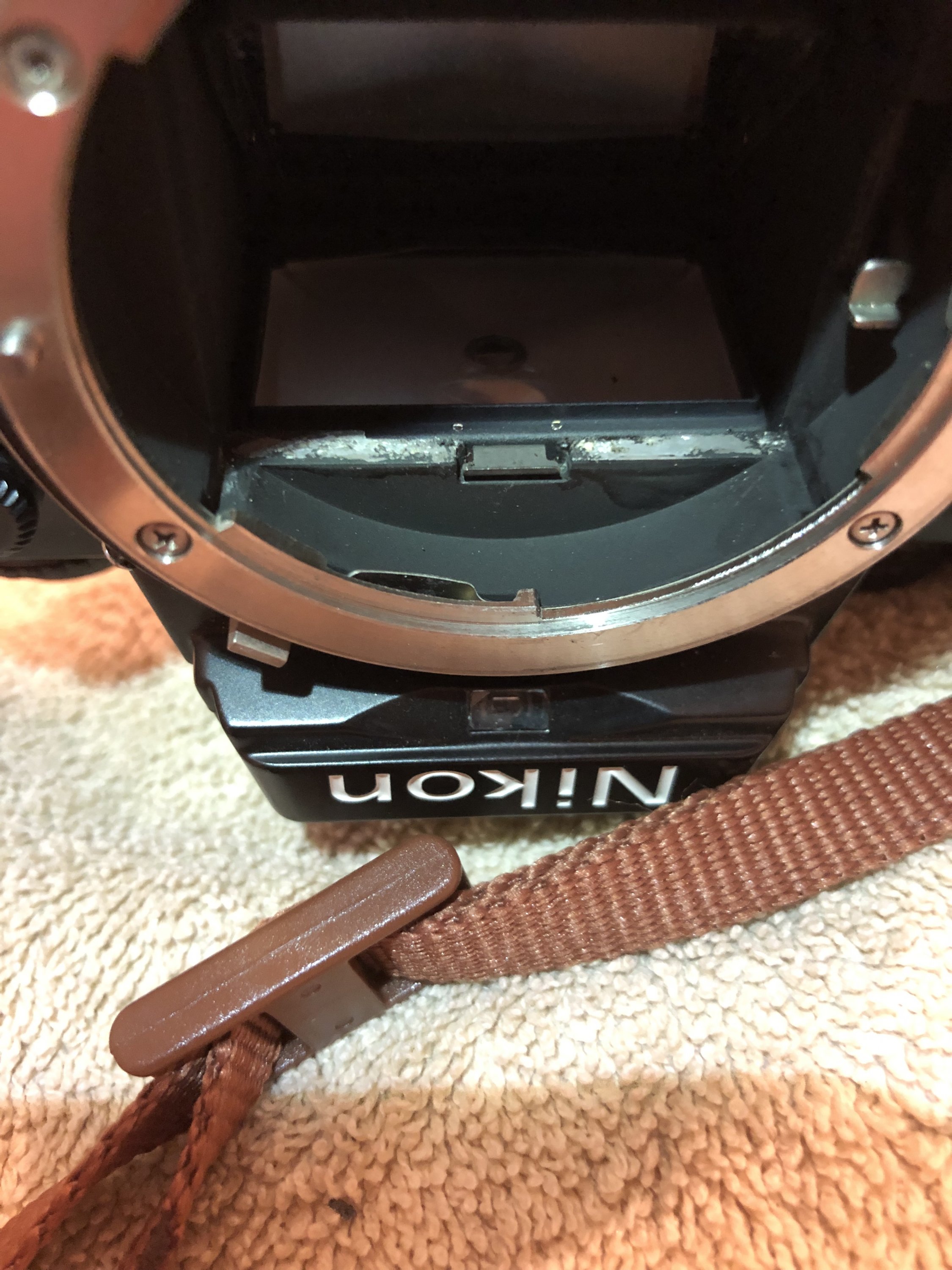

So I began the process of cleaning the area where the old foam was, and I don't know if it's clean enough to put the new foam down yet. Thoughts?
P.S. While working on my camera, I unfortunately got bits of the old foam on my focusing screen. How do I clean this?

Double check for loose paint chips and if all are gone apply the new foam.
Use caned air 4 to 6 inches away holding the can steady while moving the camera. Moving the caned air can can result in the chemicals spraying out onto the surface being sprayed.
Cotton swab moistened with 90% Isopropyl Alcohol and very gently wipping if the foam will not blow off.

Sweet, thanks man!! I got the foam in there, I just need to get things cleaned up. Frustrates me a little bit because it was perfectly clear before I took the foam out

Just be very careful not to smear the foam goo into the fresnel screen. Definitely go the canned air route first. Only use a cotton swab or alcohol as a last resort.

I took a Sears shop vac once and it ripped the mirror off; never do that again; blowing with canned air while pointing camera to the ground is probably the best you can do.

Yes, that's what I do. I've replaced the seals and dampers on the cameras owned by many other people. Before working on their cameras, I place lens cleaning tissue over the groundglass so that particles of sticky old foam won't fall onto the groundglass or elsewhere. When replacing seals, I cover the film gate to protect the shutter.
