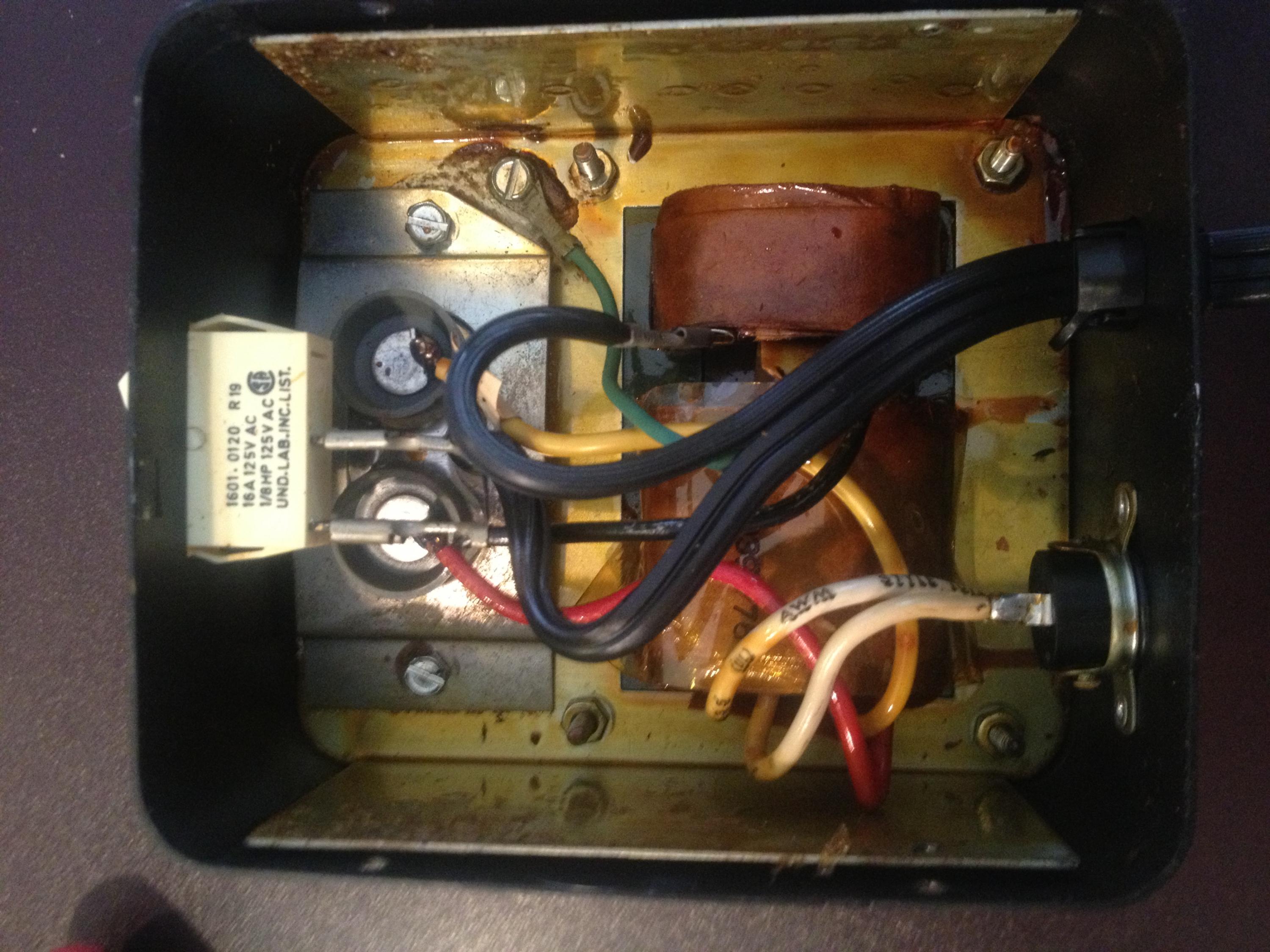

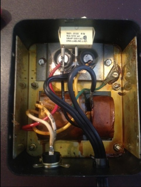

Looks pretty nasty inside. I'm guessing the orange/yellow coating all over the inside (some sort of fluid leaked out all over the place?).
Is the big thing in the middle the capacitor in question, or is that the transformer?

I just opened mine up. That's much cleaner than mine. An only repairable part is the capacitor which is located at the top of your image behind a shiny metal. To get to it, you'll have to remove the switch, and 3 bolts around it including the ground and it will come out.
Do you see any charred connection/wire?
Modern laptop power supplies are switching type. Regulated and isolated. I'd think you should do fine with that but without seeing (and measuring ) it, I can't tell for absolutely sure. If you give me a couple of days, I can see my junk box and have anything hanging around here. Hate for you to spend $30 for something like that.
I found a laptop power supply listed at best buy that is 19V, 100W for something like $30. Might be an easier way to go, I'm thinking? If the output is controlled enough to not fry a computer, I imagine it would be ok for enlarging too?
Tim
Is that dry? It does not look different from the usual lacquer that most transformers are dipped in. I don't see a regulated supply, just a transformer. Is there any more to it. Can you check the resistance on the primary and secondaries of the transformer. This sparked and smoked? Is there a fuse?
What do the two white wires go to? What is the structure the red and yellow wires go to?

Actually, the transformer visible in that picture of the internals looks like a ferro-resonant constant voltage transformer. Note that there appears to be core between the two winding sections. This was pretty typical for CV stuff - Sola is one brand name I remember. I'm not sure what the gizmos on the plate on the left are but looking again, they are probably terminals of a capacitor clamped down and sticking out the underside of that plate/chassis.
What is under that plate presumably holds the key. There are indeed usually capacitors in ferro-resonant supplies and caps do not age gracefully.
(Of course, it could be good now that you've let the smoke out. :whistling: )

It's a ferro resonant transformer. Behind the steel plate on upper half of the box, there is a large oil filled capacitor. That and the extra winding on the transformer act as a regulating mechanism. (I have the same unit right here)

Actually, it looks very simple for an enlarger power supply. That is a ferro-resonant transformer (the big thing with brown coil windings), which works with the capacitor (the other thing) to regulate the voltage. These capacitors frequently fail, and my guess is that was what happened. You can probably replace it easily, but the value (microfarads and voltage) is critical, and you need to replace it with something with the same ratings. As for the computer power supply, it looks like that would work fine. Your enlarger does not seem to have any strange circuitry, just a regulated power supply and a lamp. Before you buy the supply though, check to be sure the power wiring goes righ to the lamp and that there are no additional electronics in the enlarger. If there are, you may need the regulated ac supply, not the dc you get out of the computer supply. You may be able to find a local electronics hobbyist of ham radio operator who can help you.
