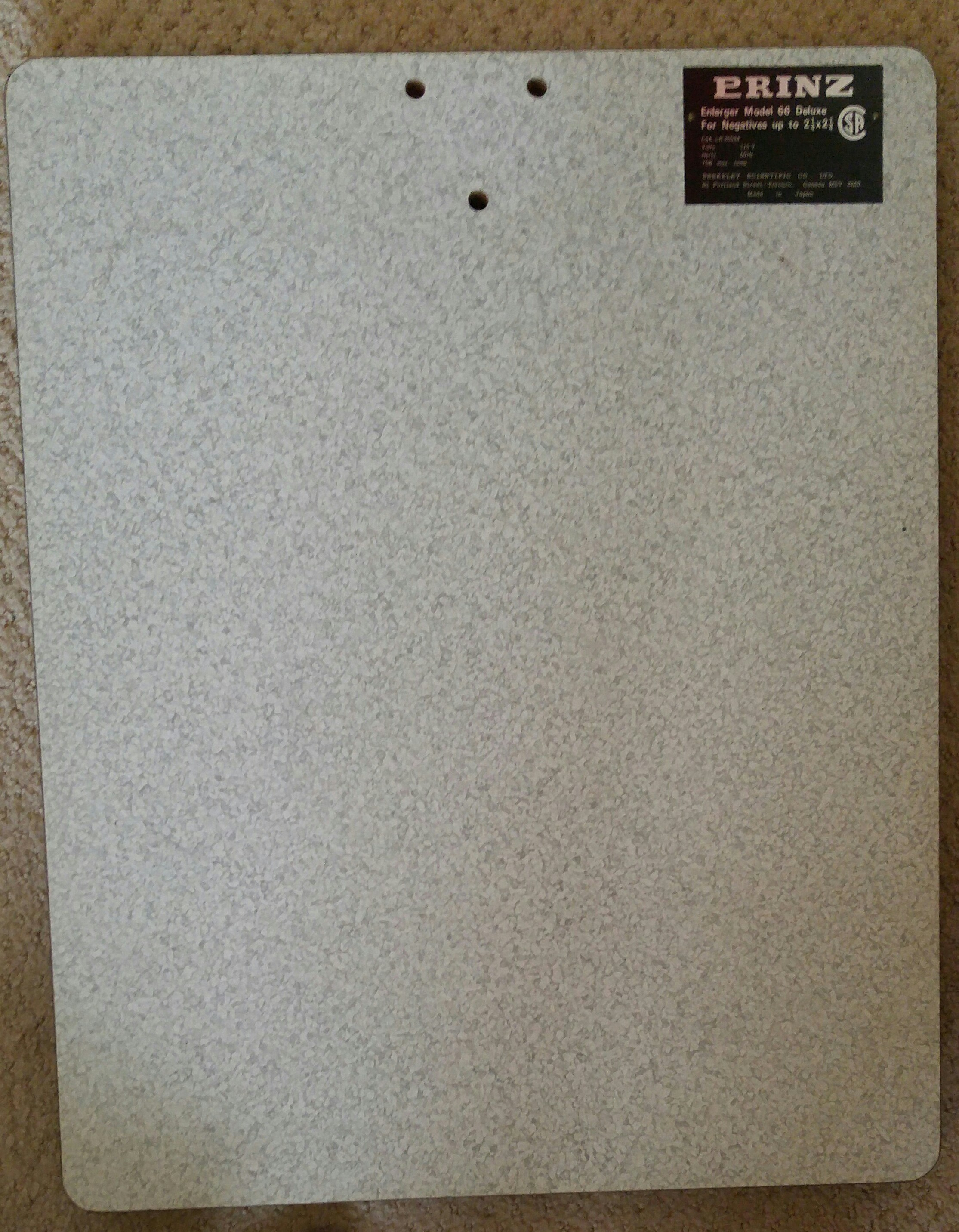

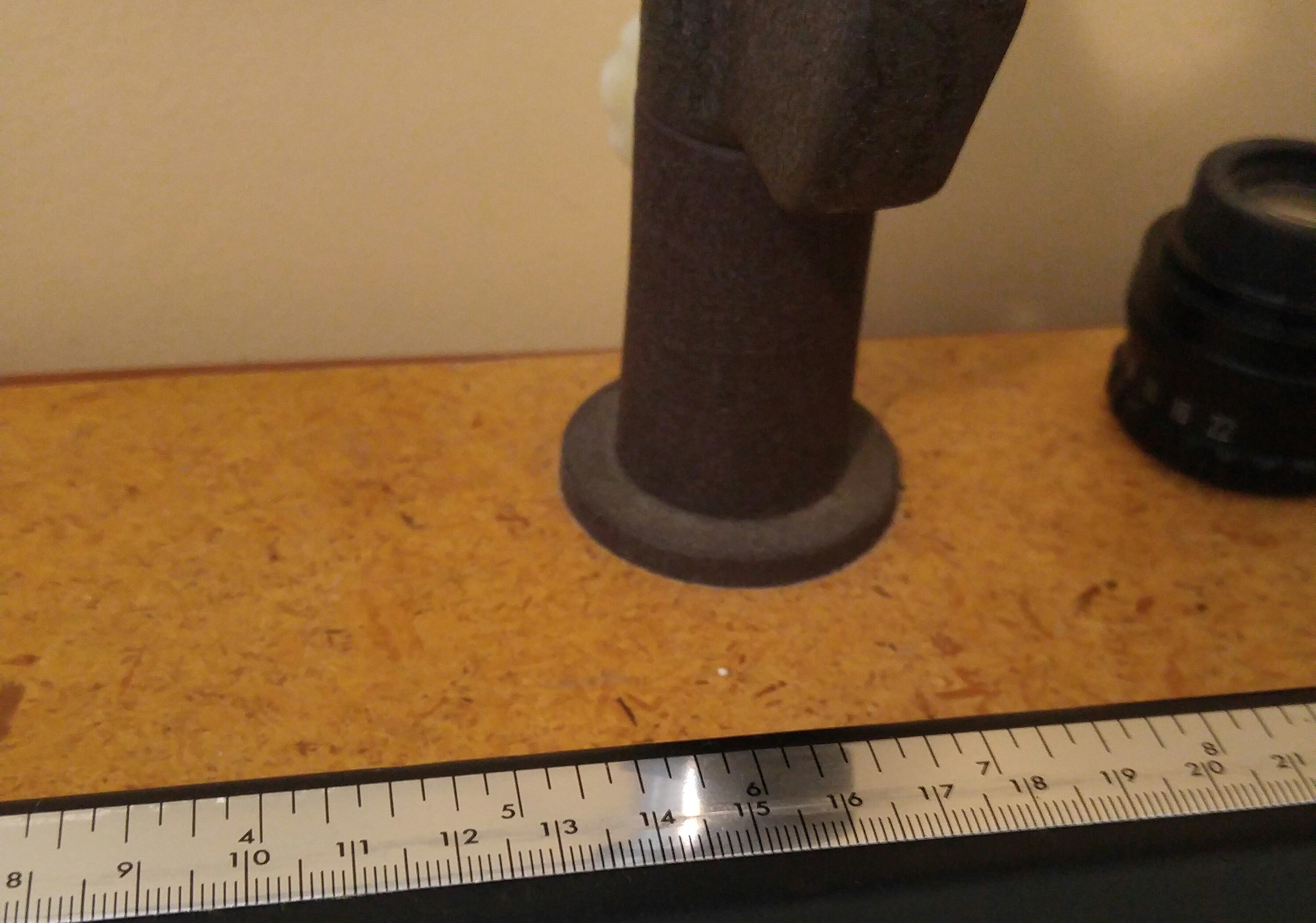

Ok so I have an enlarger with this kind of mount... How would I take it off??
Also, I want to mount it on this base board.

Yeah guys, he doesn't need a baseboard, he just needs to attach it...
Chances are the enlarger mounts with some kind of threaded bolt vs. wood screws... and that the baseboard uses T-nuts... (but then, looking at your photo... I dunno...)
So, you need to ID the thread size of whatever bolts are used... take one to a hardware store. Then you need the right thread of t-nuts, and a way to drill a clean, straight hole for the t-nuts in the new holes in the new board.
If that's not the case, I'd just take the old baseboard to a hardware store (with the mount on it) and have them tell you what you need. Chances are you'll need to drill a hole or two or three through...
