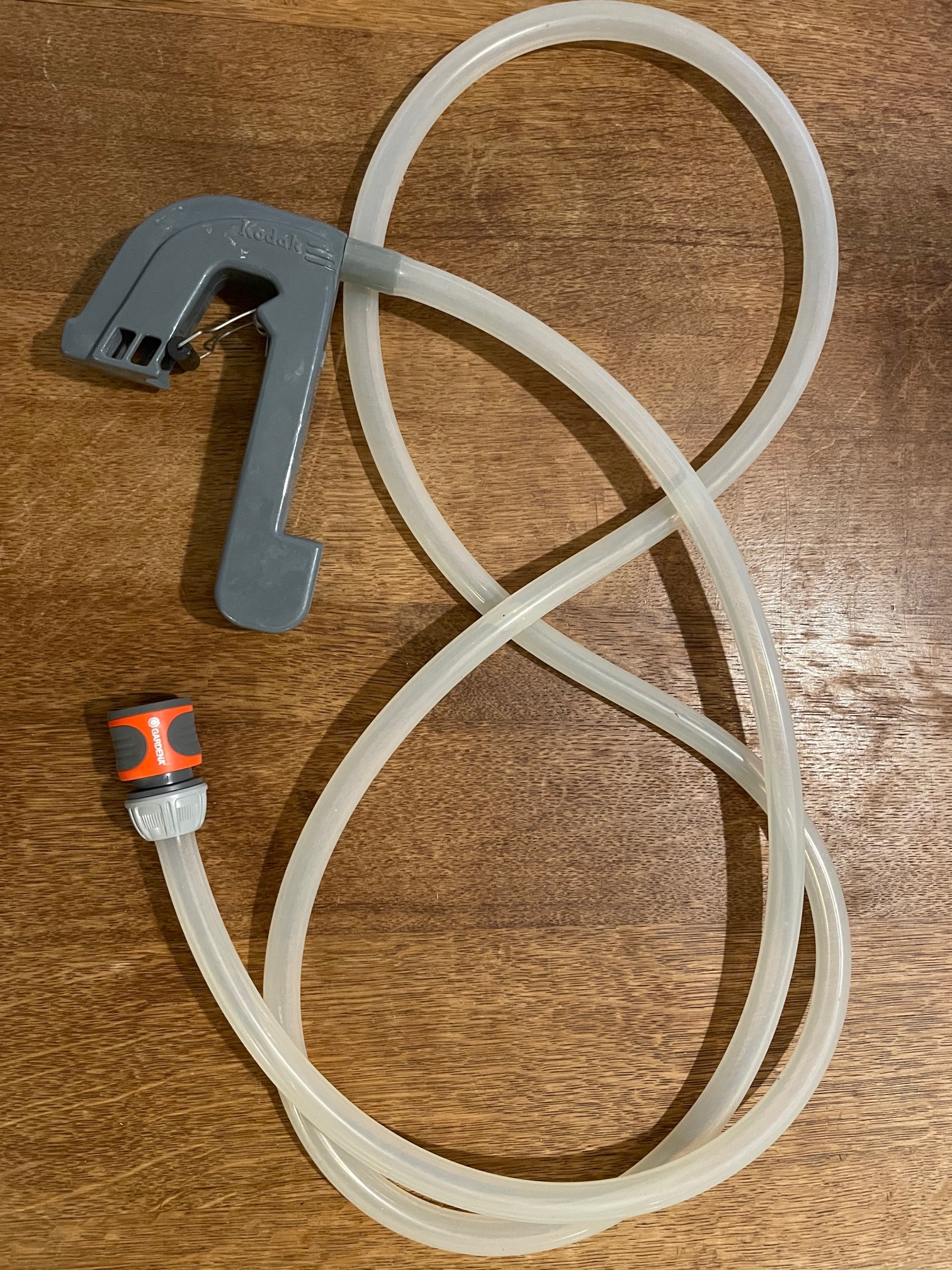

Many wash-tub faucets have threads that will take a garden-hose-style female end, The threaded fittings are fairly standard, and you can get something that reduces to the size of the rubber hose.
Truzi said it, I'll show it:
I am in Europe, the most known garden system is called Gardena, you surely have something similar. The connector on my hose in the picture connects to the counterpart. The very flexibel hose is made of silicone. I have a large darkroom sink, so I decided on a much longer hose. In fact, I have two of these silicone hoses with the Kodak siphons. This is for washing 20x24in. (50x60cm) in two trays, going back and forth multiple times. For this, I got a 2-way connector of this brand, on the tab . . .
The nice thing about the silicone hoses is they're soft and gentle on the fiber prints. Plus, I can simply lay them in the sink ...
I don't always use the Kodak siphon, because it is not always practical. Mainly because my trays need to be raised for the siphon not to touch the bottom of the sink. In that case I just use similar hoses . . .
