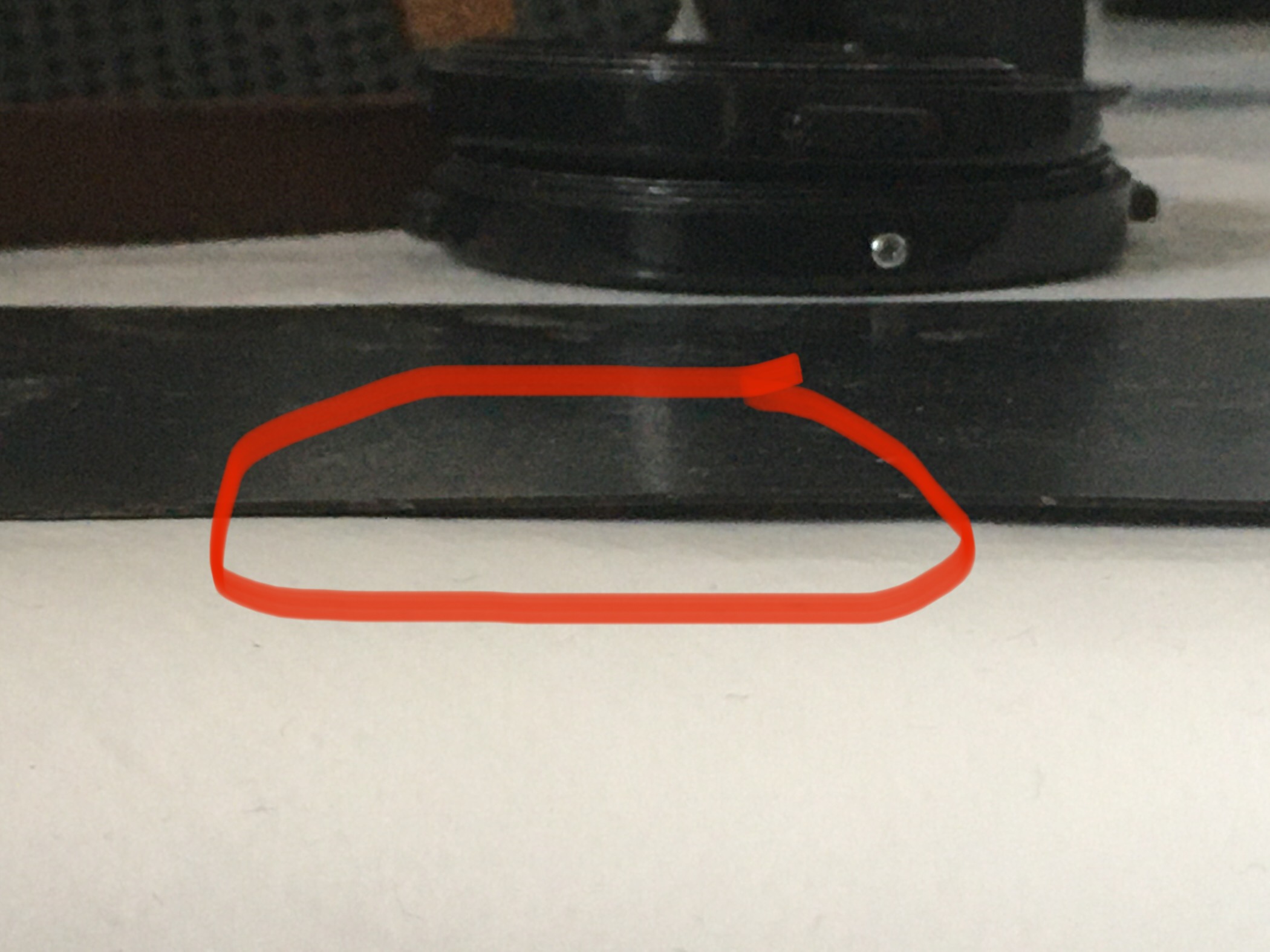

Hi all,are there any tips to repairing a bent easel blade? The blade in question has approximately a 1mm + rise from being flush. I have included a photo although not the best the problem should be evident.
Thank you in advance.

There is no other technique as with any critical straight-bending of metal sheet.
At least one, still straight part should be clamped straight (vise, clamp etc.) and the other part bent, working in short distances sequentially through the bent part.
I put a bar magnet on mine when I use it, my easel is all steel. It also helps keep the blade flat with curly paper. The blades are very light and over the years of use they bend, no big deal.
Put a pencil directly under the bend and gently bend it back a bit. That little bit doesn't seem significant enough to bother with, though.
Thank you for your replies. The bend certainly doesn’t look significant enough but in practice it is. I tried magnets but have so far not been able to find any strong enough. The bend will lay flat with downward pressure but that’s not ideal when dodging burning etc.

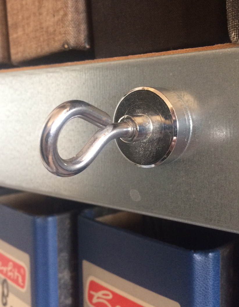

You're right, I read the word bar wrong. I thought it was like a handle to make taking the magnet off easier. Here a picture of a magnet I have. It is strong and would do the job. But I am not sure about the shiny chrome, for obvious reasons. A rectangular black bar magnet would be safer.
Anyway, on this end it won't work: the Leitz and RRB easels have a wooden base.

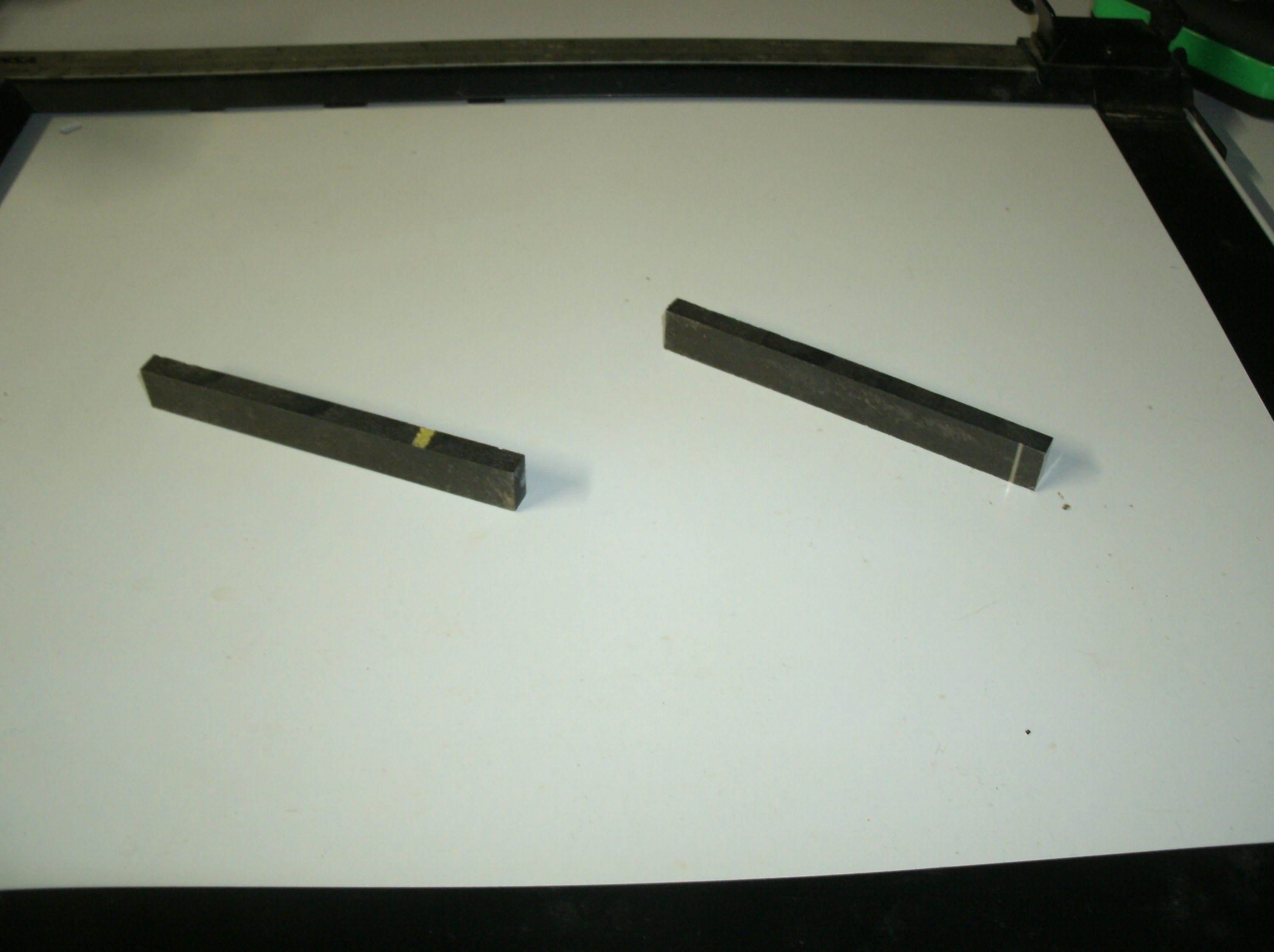

These 4" bar magnets are left over school supplies from when I home schooled my youngest daughter, they work perfectly with my two blade easel.
