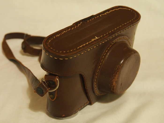

Here's an informative video where a Japanese gentleman restitches a Leica case and gives tips in both Japanese and English. Very informative.
I then invested $10 in a leather repair kit from China on Fleabay: https://www.ebay.com/itm/13-Leather...919705?hash=item4d98ac70d9:g:Ri4AAOSwTC1dNeLh
The thread is worth the purchase price alone and the tools are fair, but not built for professional daily use.
It took a bit of effort, but I was able to restitch an Ansco folder case myself in a few hours.

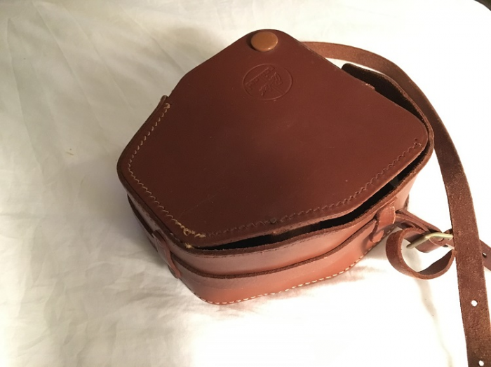

I’ve repaired a few cases. Below is a Bolex movie camera case for a B8 or C8 camera. The first step was to remove the old thread, this is the hardest part because the rotted thread falls apart when you try to pull it through the holes. The next step was to sew it one direction using the old holes. As you can see in the second photo every other stitch is missing. This is because a machine uses two threads, you can do this by hand but it's much easier to just work with one thread. Originally this was done with a machine but it takes an expensive specialized machine to sew heavy material on a corner like this. After making one pass I made a second pass going back in the other direction sewing every loop that was skipped on the first pass.
Both sides of this case needed to be repaired. There is an inner part of this case that the camera mounts to but that thread still seems to be in good condition so I didn't do anything with it. You can see that there is a nail directly in the path of the stitches, there is an identical one on the other side as well. The nail supports a wood brace inside the case. I had to pull the nail out a little to sew past it. The leather on this case was still in pretty good condition so it worked out great.
There are a few sites that I looked at to learn how to do this and what needle and thread to use, probably the same as what Trask has.

This is the first case I repaired, it’s not my best work but it’s useable.

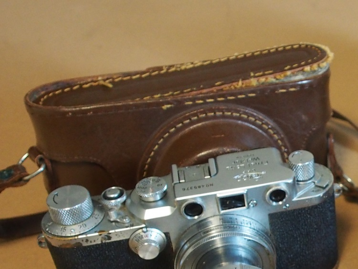

In my experience, when the stitching has gone the leather is in pretty bad shape. I have though of getting thin strips of leather to serve as reinforcement and gluing it all together, but have never trying it. So many old cases, so little time...
