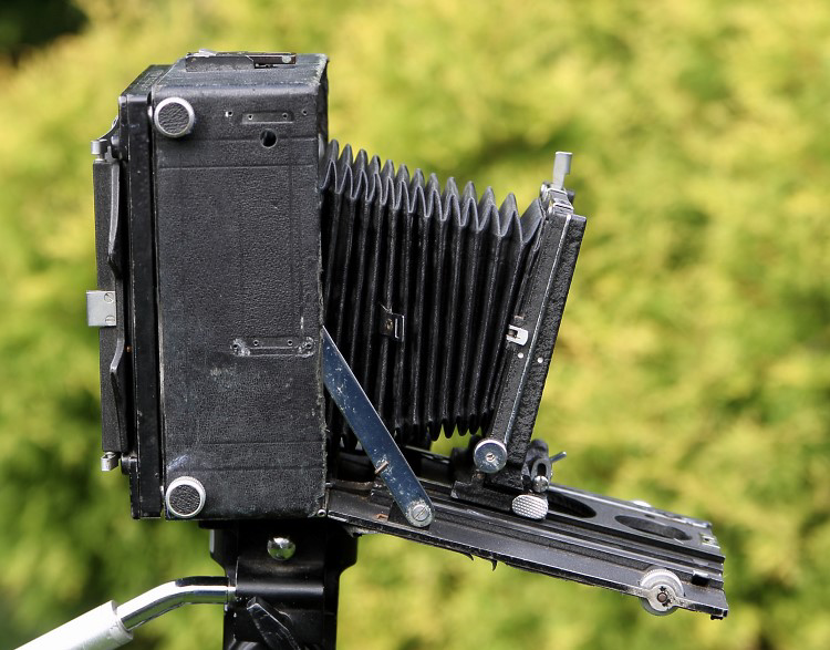

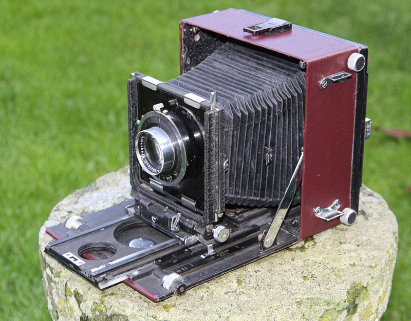

I've restored some MPP MicroTechnical cameras essential a British made 5x4 Linhof made as part of War reparations, MPP had access to Linhof data from the factory.
However MPP used a covering material that doesn't age well. I bought this and another in bits for £70 a bit less than $100. I sourced the missing bits for the second then re-covered both'
This is the one above now , the other is dark blue, Reality is in this case online people miss the issues seen at say a camera fair the tatty MkIII's are dirt cheap but it's cosmetic rather than functional.

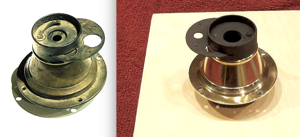

I like to make my equipment look like new. I'm not into 'vintage' or 'old-time' photography or gear.

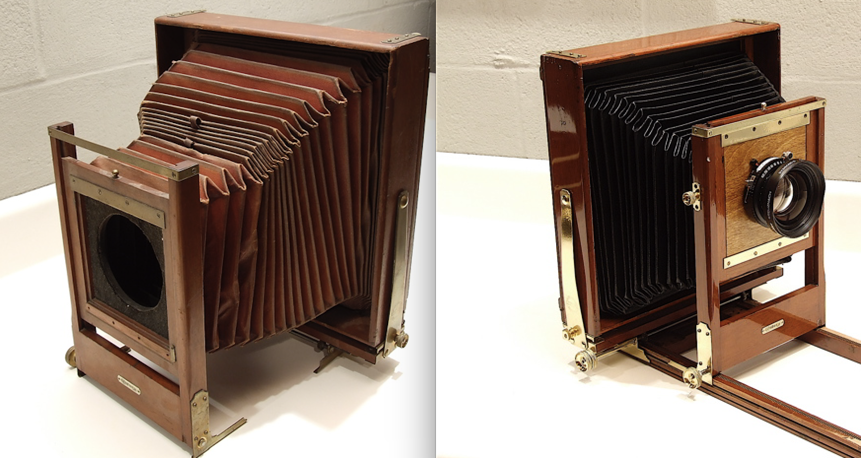

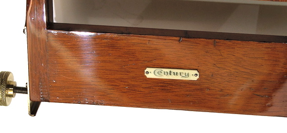

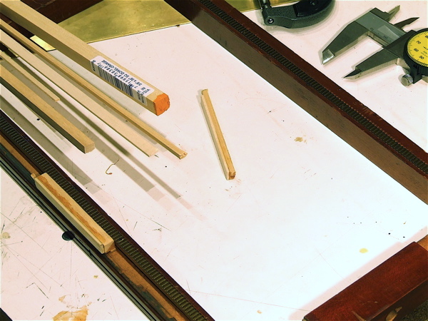

Donald Qualls
Jan 19, 2005
12,309
North Carolina
Tel
May 9, 2011
973
New Jersey
Seamless finish--you'd never know! Could almost be a very early Gundlach, but it doesn't have the fancy brass corner plates on the rear standard, so I'm going to guess it's a Century....
