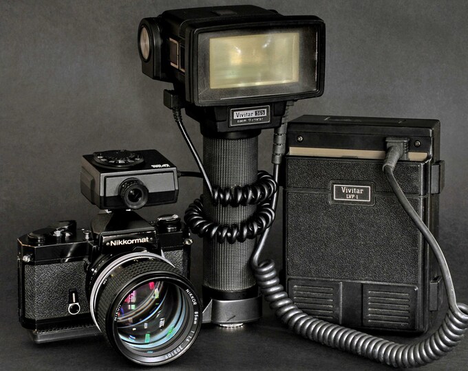

I'm somewhat inspired by the 'Electronic flash for Crown Graphic' thread in the Large Format section here. So I dug out my circa 1978 Vivitar 365 flash (random web photo of a 365 below), attached it to my Crown Graphic, and shot some test images using my LomoGraflok. It actually worked fine; however, after repeated triggering, I detect a faint 'electronics' odor.
Does anyone know a reliable place to have my 365 serviced? Or should I just use it occasionally until it dies, then pick up a replacement on the auction site.

Never mind the flash, look at that lens! It's unusual to see a Nikkormat dwarfed by an 85mm lens.
