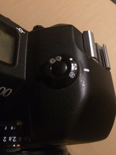

I have been inside my F100 to repair the meter select switch and the diopter adjuster. The plastics they used in these cameras are lightweight and thin. The camera shutters and focus motors themselves are overall pretty durable but some of the smaller components are just going to fail much earlier than the 1970s cameras. I ended up using spare screws to replace the detents that had stripped out on the meter switch.
The reason I had to repair the diopter dial is because the very fragile device that moves the diopter lens broke when I opened the camera to fix the metering switch.
I had to use some thin wire to wrap around a delicate plastic stem that slid on the steel rod that adjusts the diopter. It works and is stronger than before but its not something Nikon would approve of.
