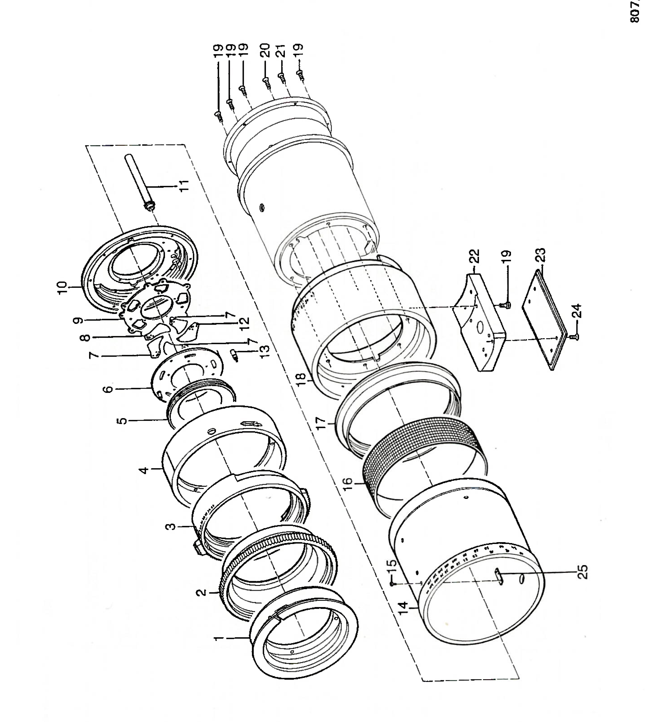

As the header explains, I'm in need of the specific repair manual pages for Hasselblad 500mm T* and clear photographs of lens back area, disassembled, so I can seek out any missing pieces from my recent acquisition of this lens, which is in otherwise great condition and needs use soon.

I think there are 3 500mm lenses, but this one is on the 'learn camera repair' site. Not sure about the Tele-Tessar and Mirrotar.

Yes, this helps but I need to see the lens mount area from the back perspective, as it is the large, empty end tube, onto which the mounting plate caps that I need some images of.
One part of this is the length and shaping of the Mount's Cocking Arm that rides inside the smaller, internal tube of that larger tube.
The second part is any mechanism that signals to the shutter that the camera has fired.
Lastly, the correct order of reconstruction of those parts and the mounting plate into a stable, strong condition.
The lens is the Tela Tessar 500mm T* and, as I said, the rest of the lens, from below the shutter housing and including the glass is perfect.
Is there perhaps any optical element below/back of the shutter assemble?
I'm just no sure without more pics and drawings.
PS: Where in the repair manual on camera repair did you find this page, please?
