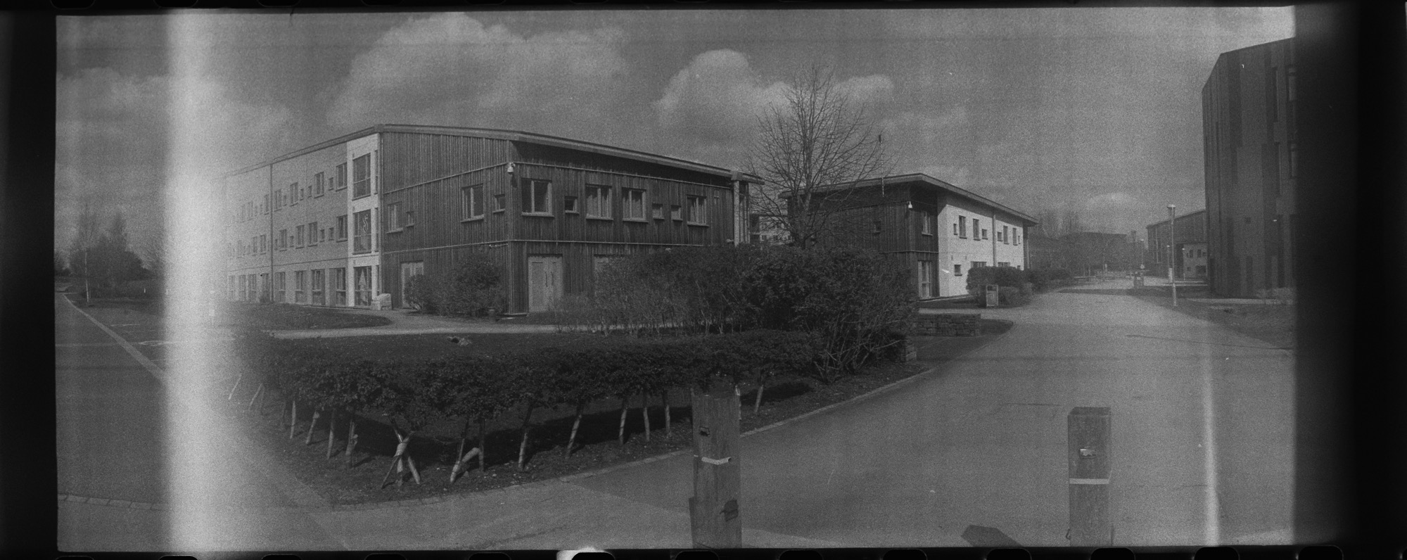

Here's how my negatives looked before sending it back to the repairer. I don't understand where the gridlines have come from, they were on my rough Epson scan but also on this which is from using a Sony A7RII on a lightpad, so I guess they are courtesy of the Horizont.

I noticed nothing unusual when takes shots, but obviously I wasn't watching the barrel rototate; there were no strange or clearly uneven noises. The sun was very strong that day, so the bright vertical bands could be down to light leaks. But the fine gridwork of vertical and horizontal dark lines all over the photos is beyond me.
