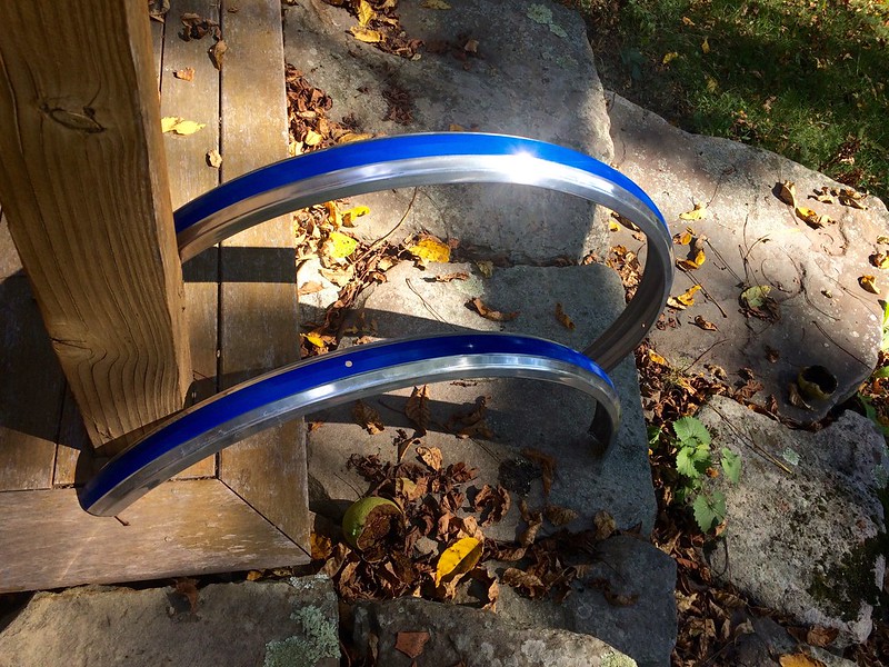

For what it's worth: if it is aluminum, there are chemicals used by the aviation crowd for painting their planes. I picked some up (FAA-approved!) for painting some aluminum fenders that turned out pretty well; it's an etching treatment and primer combo, which you follow up with the spray paint of your choice. Google Alodine.
FWIW, the fenders turned out well and the paint job seems durable.
