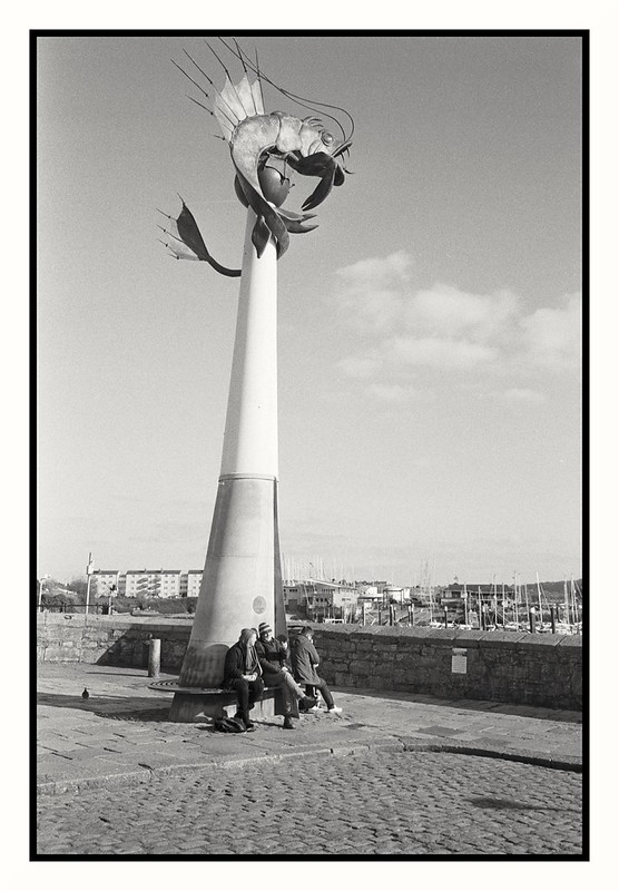

Hi Frank and welcome back to film. It is not advised to use partial rolls of film in testing since the ammount of emulsion has a direct bearing on the final outcome, especially when using highly dilute developers to near exhaustion. I use HP5+ @ ei200 and develop in HC-110 which is very similar to your chosen developer. I develop for 12 minutes @20°c in 1:63 with my own agitation regime that may be called minimal or suchlike. I like the results as they are repeatable and show no defects or weirdness that can plague those who use full stand regimes. My usual way is to agitate for the first 30 seconds and then only 2 more invertions at 4 minutes and 2 more at 8 minutes and that is it. My only other reccomendation beyond testing is to use a 2 reel tank and only load the top reel as this can help reduce surge marks and artefacts and also with dilute developing, you still need adequate volume of developer to complete the job.
Here is a recent example.
Sculpture (Prawn on a Stick) The Barbican, Plymouth. by John Bragg, on Flickr

A question for you: how did you meter for ISO 200 on a Mju II? Did you put a DX sticker for ISO 200?
Your pic is showing a bit of uneven development. Scanning is very unforgiven.
How's the black leader part? Put it against a very strong light and does it show white streaks?

Hi Ricardo. Scrape and tape method of re-coding film. Sharp knife and insulation tape. Didn't notice any uneven development. Leader was black and even as always.

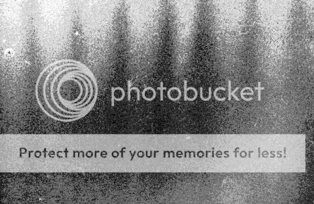

Hi John,
Thanks and another thanks for adding the pic to one of my flicker groups.
It's just that there is a whitish strip of the left side running almost the entire length.
So, if you S word the leader you won't get this:
I've had this happen until I changed my initial agitation routine.
You won't necessarily see it at naked eye, but it is in the S word.

Thanks Ricardo. I used to have a problem with Jobo tanks and reels but I found that using only the topmost reel of a 2 reel tank cured the problem. It looked like surge marks and was most noticeable with Rodinal which I no longer use. This time round I gave 30 seconds initial invertions with a slight twist. I know that the induction time of an image is crucial, and up til now have given 15 seconds. The intent is to give mid tones and highlights slightly more development (very slightly) without giving more time overall and without affecting the compensation in the shadows. Realy FINE TUNING as opposed to huge changes. How do you do your initial agitation ?

Pretty much the same now, 30 seconds instead of just 4 inversions at start.

I think that is very important, in that the majority of the development happens in the induction period. I realised that years ago when tray developing orthochromatic lith film positives for screen printing in red safe lighting. You never get to see panchromatic film like that but it was educational ....
