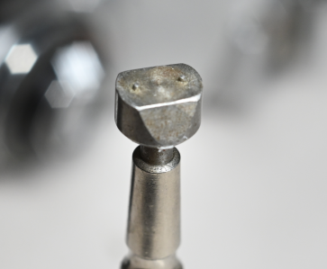

which way does it turn? self timer screw on an ME is LEFT HANDED, not sure if it is the same on an ME super, but the ME super manual refers to seeing the older manaual for some steps.
I tried counter-clockwise, is this what you suggest?
Things that are made to turn to the left (counter clockwise) are sometimes fastened with screws with a left hand thread.
Try turning the screw clockwise to loosen it.
Back in the 60's I tried changing a tire on a Dodge. At the time the Chrysler corporation used left hand studs for the wheels on the left side of the car. I felt rather stupid with a broken off stud and nut in my hand. Then I noticed the 'L' stamped on the end of the stud. Then came enlightenment.
The self timer screw on the ME Super is indeed a left hand thread so you would turn it clockwise to loosen. Attached is a photo of the factory tool for removing this part on the ME Super, you could make this tool out of a flathead screwdriver and a file or Dremel tool.

Yes, turn the screw clockwise to loosen. A tool similar to a rubber stopper is safest as it's very unlikely to scratch or elongate the holes. Japan Hobby Tool sells sets, but I imagine any number of improvised solutions would work.
Wow that's cool that you have a photo of the tool! I use a spanner wrench like I said, and it was quite difficult already for me to obtain (I knew what I needed... but I had no idea what it was called!).
Also thanks for the recommendation - a clockwise spin it was!
