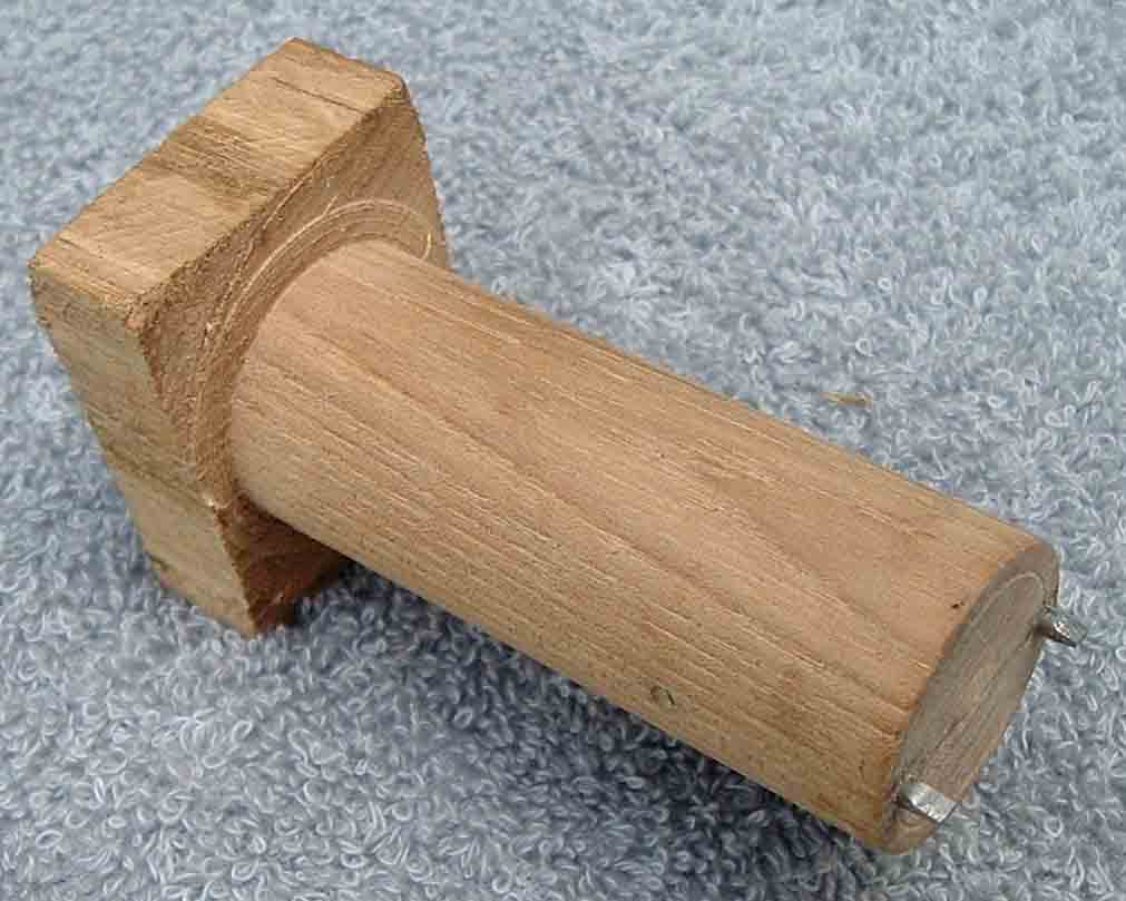

Yesterday I couldn't find my spanner, so I made one just for the rear lens cell of an older Yashicamat. The lense is set deep enough in the cell that a sheet metal blade flat across the tip mould have worked well. If the cross-section of that tool is in a Z shape, it might resist twisting better. Instead of trying the easy way, I made a tool of oak with two piano wire pins epoxied in the end and filed down to fit the slots in the cell. The cell wasn't difficult to remove. Nails set into pine and filed to fit the slots probably would have worked as well.
