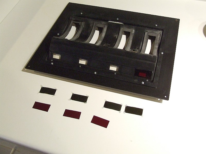

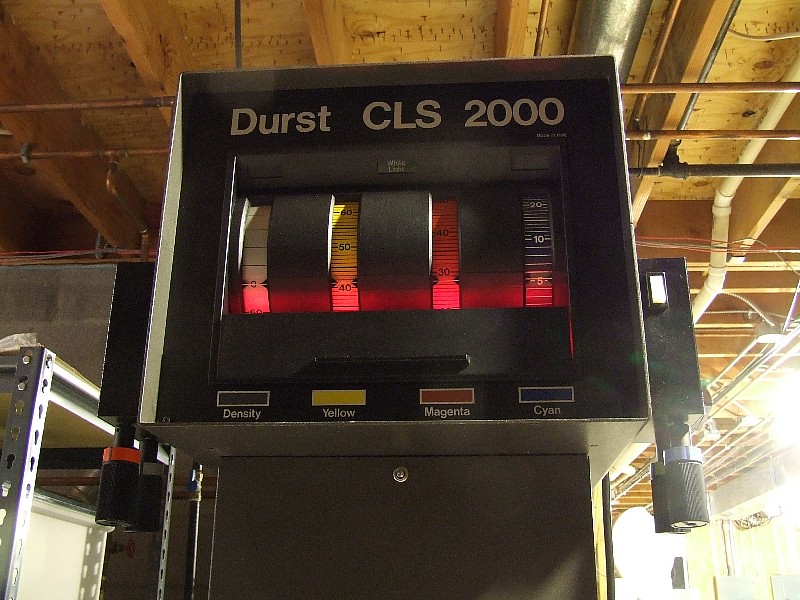

Good to see that supplementary filter holder being put to good use in B&W printing. Thanks for sharing your success.
Another thing I did to 'convert' my CLS2000 to B&W was to change the filters over the bulbs that illuminate the dials so they are safe for B&W papers.
