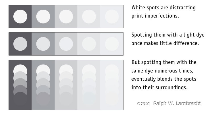

I vote against that method for several reasons.
The appearance of tone very much depends on the surrounding tones (see 1st attachment). Testing for an appropriate tone on a white border will always leave you with too little ink, because the test patch will look darker than what you actually need. This in itself is not a bad thing, because it is better to err on the side of lightness rather than ending up with too dark of a spot.
However, the method also implies that the right tonality has to be applied in one go. That is not the case. Once should apply numerous applications of light ink, slowly moving up to the right tonality. This is hard to do on the white border away from the actual application area. It's better to apply very light ink several times (five or more) until the surrounding tones are not quite matched. At that point, spotting can be stopped before it becomes detectable (see 2nd attachment).
Thanks Ralph. I have been fully aware of these issues of apparent tones for quite some time now, and do apply corrections in steps.
