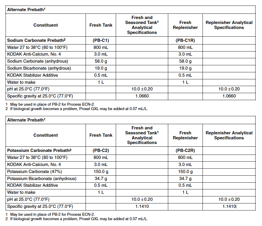

Kodak offers two alternate prebath formulas in the "Processing Kodak Motion Picture Films, Module 7, Process ECN-2 Specifications" document, available here:
http://motion.kodak.com/motion/uplo...t_en_motion_support_processing_h247_h2407.pdf
Attached below is a screen capture of that page.
I used the one with sodium carbonate and sodium bicarbonate. I also added a few drops of jet-dry.
