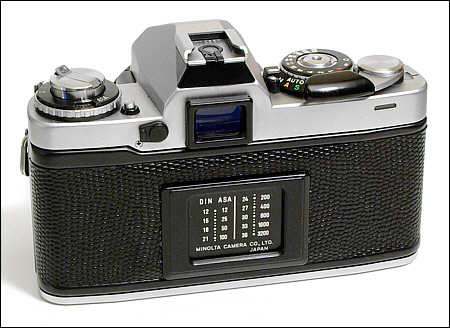

By the way, I've re-covered several Japanese cameras, including two Contaxes (137MD and 139 Quartz), a Yashica FX-D, Minolta XD-11 and a tiny Ducati Sogno. The Minolta covering had shrunk like a cotton T-shirt in the dryer, while the others had simply worn away.
Here's the Minolta with a new covering from Aki-Asahi:
