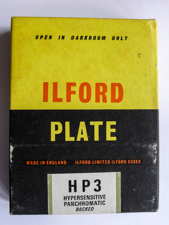

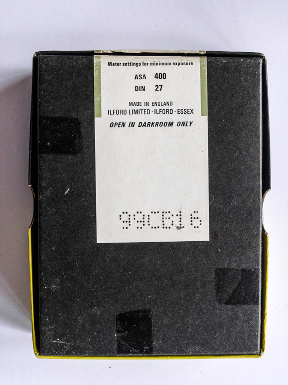

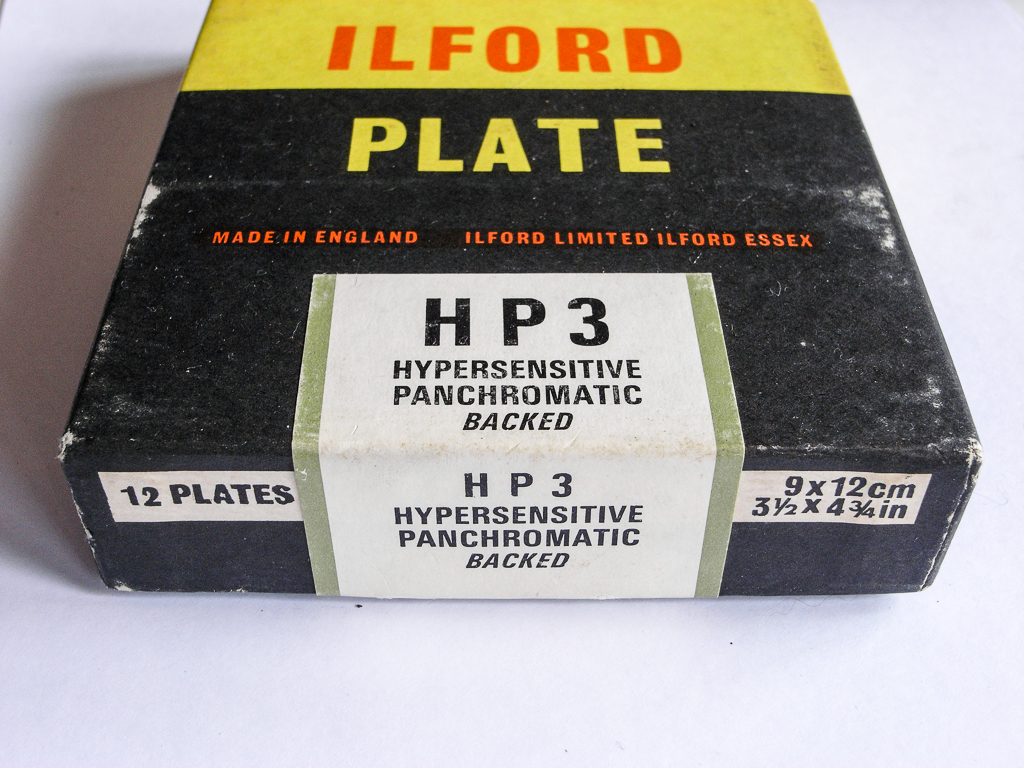

If I post the box details, with any batch numbers etc, would it be possible to date the material?
Nov 2, 2005
2,034
Cheshire UK
Dear Pdeeh,
No it will not be possible, if you take a photo of the box and post it I should be able to approximately date it.

Sorry it has been so long Simon, but here are images of the box.
