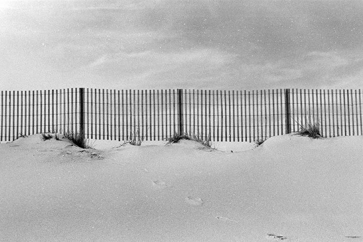

Hi all,
Lately I've been having what I originally thought was a dust issue, but after some poking around on APUG, I'm now convinced it's sediment build-up in the fixer that has made it onto my negatives.
My question is, what is the best way to clean these specks from my film?
Should I pre-soak, re-fix (with new fixer), and re-rinse (+PhotoFlo) & dry?
Or would just a rinse +PhotoFlo do the trick?
I'm hoping these negatives aren't a lost cause.
Thanks in advance!
Joey

Probably further fixing is unnecessary.
Possibly use rinse with a very soft brush to persuade the particles to leave without scratching the film?
I never heard of sediment in fixer.

How does the negative look like? Can you see the spots on the negative or only after scanning?
If you can see them, on which side of the negative are the spots?
As you indicate this is "sediment built up in the fixer" - how do you fix your film, why do you think so?

If there is some substance on the film, it is safe to clean developed and fixed film with isopropyl alcohol and a gentle cotton wipe.

I have been filtering my fixer through a coffee filter to avoid particle spots like this. Solution B of PMK Pyro has a ton of particulate that I also filter.

Every post has good ideas:
  • filter chemicals
  • wash and PhotoFlo or equivalent
  • isopropyl alcohol and a gentle cotton wipe
Welcome to APUG​

To me it looks like a Photoflo issue, an improper use of this wetting agent.

Update: I disposed of my old fixer to mix a new batch, and the bottle had SO much sediment in it (a lot of it stuck to the inside walls and the bottom of the bottle) that I decided to get rid of the bottle itself and use a new one. Results: Zero issues on the rolls I've processed since mixing the new batch.
For the curious, I use Ilford Rapid Fixer.
I think the main cause of the problem was silver sediment sticking to the inside of the bottle, which I didn't notice when mixing new batches of fixer. So even though it was a new batch, the sediment was still present, and only increased as I used and reused the fixer (gathering more silver particulate along the way).

Particulates that get embedded in the emulsion are very hard to remove. In addition if one IS successful the particulate usually leaves a mark in the emulsion. Best to prevent them in the first place.

Joey, your problem may have two causes:
- impurity glued on the film emulsion (silver grain with gelatin);
- an impurity inside of the emulsion layer.
If impurity is on the emulsion surface is chances to remove.
Use an alkaline solution of sodium carbonate (20 g / l) for 2-3 minutes at 20-25 ° C.
Gelatin emulsion layers will swell, and the impurity is more likely to be eliminated.
Wash with water about 5 to 10 minutes after which a solution PhotoFlo used to prevent water stains.
If the impurity is inside the emulsion you have no chances to remove.
It is a problem that comes from the film.
To set where is the impurity (on the emulsion or in the emulsion) using a magnifying glass with reflected light.
I use isopropyl alcohol for wiping grease stains, oil on the film.
George
Happens all the time especially when the fixing bath begins to sulfurize. It's a good idea to filter solutions that are reused before each use.
If the particles that the OP is seeing are sulfur then he is SOL unless they can be mechanically dislodged since sulfur is not soluble in anything that would not also damage the film.
