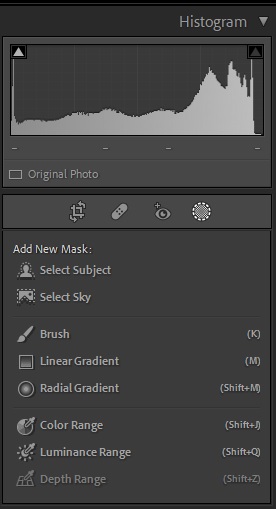

Latest lightroom has quite easy fix for this. In develop module, under Histogram there is Masking tool (dotted circle on right).
Each corner can be masked separately if color cast is different due to light angle and it probably is. Next step is to select brush and size and feathering can be adjusted.
When selection is made mask is created and adjustments can be performed selectively only on this mask. Color temperature and other color controls are available to neutralize the cast.
Same can be done in Photoshop. Adjustment layer needs to be added and selections added as desired.
These are the easiest fixes. Equivalent to LCC profile could be made but it's only effective on digital since you need to get it for each aperture and light could also change the color cast.

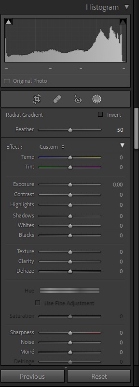

If you prefer to use gradient. Masking option in Lightroom can be also set to gradient. I find Lightroom way faster to work with images and only get them to Photoshop if I really have to.
Masking is basically separate layer just like in Photoshop and isn't destructive.
Quickest workaround here is probably:
1. Acquire LCC image of white background (at multiple f stops if needed).
2. Import in lightroom and add gradient mask
3. Settings or mask itself can be copied to any images you have. If you find any images that need further correction, every single one can be fine tuned for that masked area only.
To adjust gradient to your liking when mouse is hoovered over white area in the center, RGB values will show bellow histogram in develop mode.
They you can adjust gradient to get the same RGB values in corners.

Gradients can be adjusted in different ways. Lightroom is simpler. Photoshop has more ways to adjust it including scripts and batches that can be created for the task.
However, it looks good to my eye when adjusted like this. Lightroom lens correction tool has two sliders for intensity of correction and gradient linearity. This resolved all issues I had with fall off.
Lightroom masking is really powerful and there's little need for me to get outside of Lightroom. Masking can be applied in different ways and it's plenty for almost any adjustments.
And then when gradient (or any other one of these masks) is selected, it can be adjusted with different controls:
Contrast, Texture, Clarity and Dehaze can even repair flare if it's not to far gone. Selective sharpening or blurring, selective Moire reduction etc.
