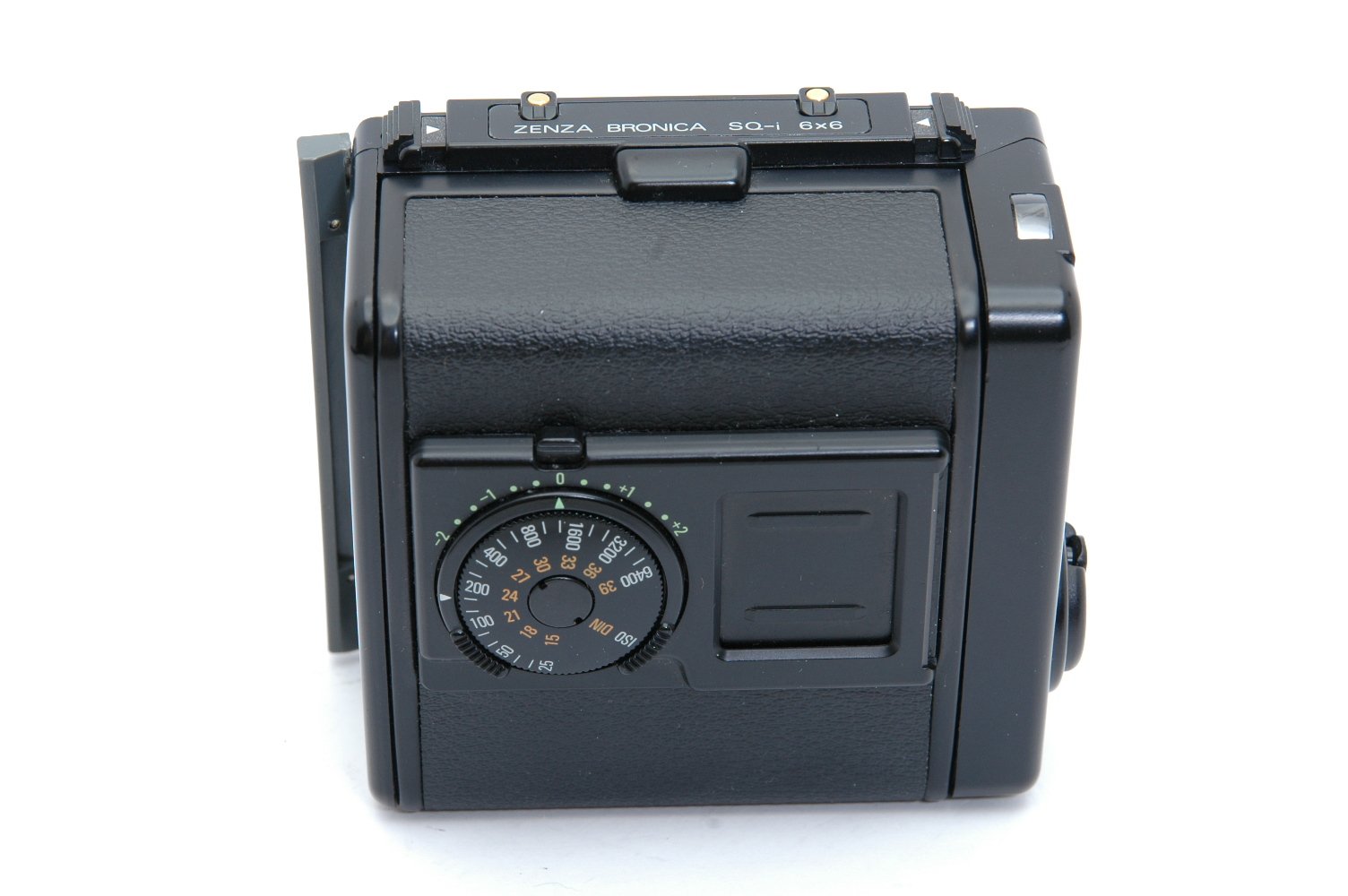

Bought a camera but its missing the dark slide. How the hell did i not notice this?! Anyway, the camera is a Bronica SQ AI with a Bronica SQ-i 6x6 back (the new (?) ones with the iso on the back).

Apparently you can test the shutter in multi exposure mode but often it wont fire if you have no film in and if the film back is attached. So, you can test this by removing the film back. I cant do this without the dark slide. Is there a way to remove the back without the slide?
I've attached an image of the back.
