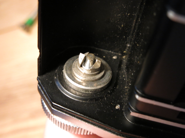

The film won't turn the sprocked weels, so I think the mechanism needs cleaning and lubing. At least I want to have a look inside to see what I can do. But I'm stuck on how to remove the film advance wheel..

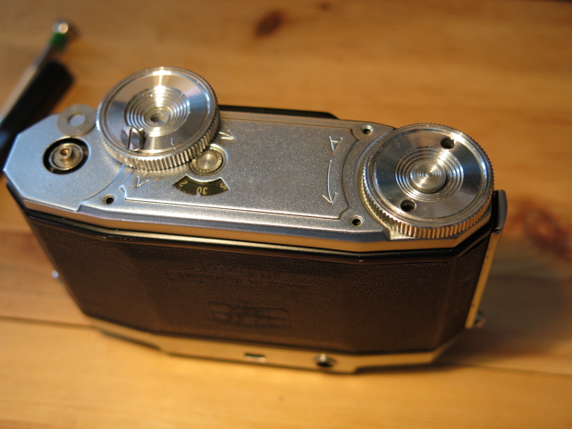

The 2 holes couples to a wheel in the everready case. I don't think they are for removing.
The only possibility I can see is to remove also the top cover to take out the spool. Then try to make a tool that goes through the hole for the axis of the spool in the top to the inside of the wheel. I suspect that that can be turned clockwise to remove the weel. I'd be able to make a stick of ebony that is allowed to be 6mm thick but if that will be strong enough, I don't know. At least it won't scratch anything.

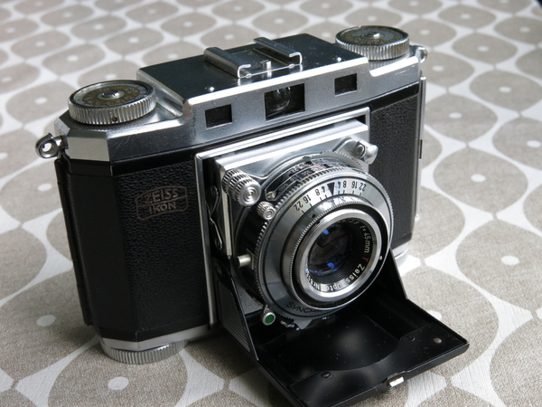

Thank you, but mine is not the IIa model. It's the plain II (and the same as Ikonta 35 later named Contina I). The film advance is different on mine: a wheel at the left bottom.

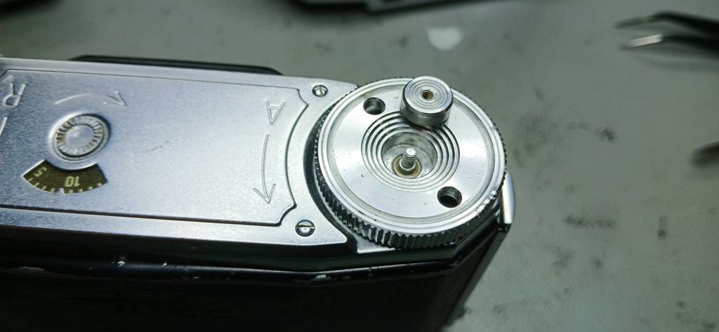

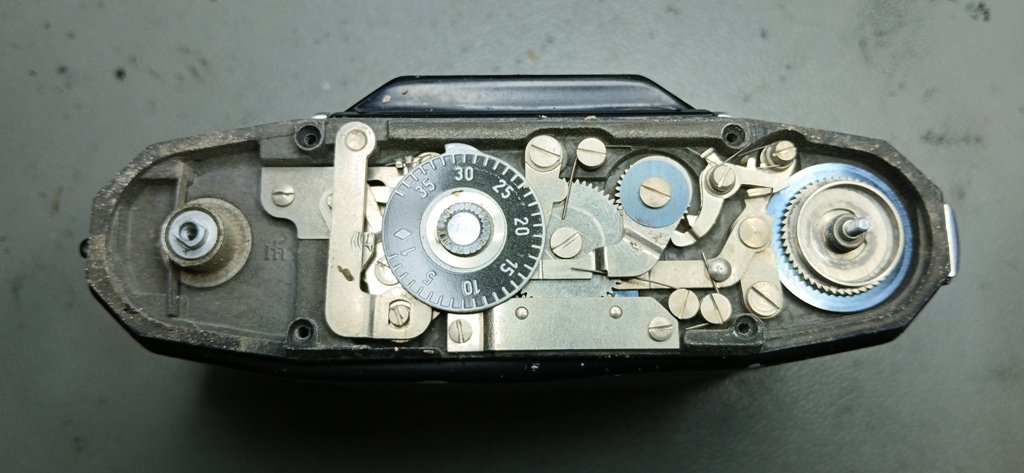

Just did this so an update for anyone else looking.
The button in the middle of the film advance is best removed with a rubber pad pressed against it or the tip of a finger with a rubber glove over it. I've just removed two and they unscrewed easily.
No sign of a set screw underneath other than the end of the shaft the button is screwed on to but nothing that needs unscrewing.
Remove the film advance knob (left hand thread)
