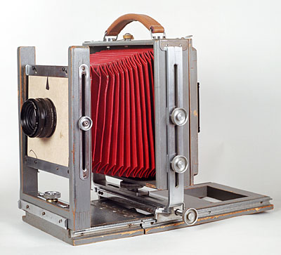

Hey,
The GF wants me to strip her camera + refinish it.
Is there a suggested way to remove the bellows? Looks like they're glued in. Obviously I want to do as little damage as possible.
Thanks
Looks like this:

The link has it down. I'd go after it with a single edged razor blade or two and try to slip the blade between the bellows material and wood. With care you shouldn't do too much harm.
If you do happen to damage it a little, use a frame inside the bellows to reinstall it with screws. 3/8X1/8" painted black. Basswood from the local hobby emporium or craft store should do.

I went down this road once... Mine a grey Ansco 4x/5x 7.
Stripped it refinished and had a beautiful and still marginally useful camera.
I'd leave it as is and go buy what you seek.
If you enjoy the process as I did so be it.
Warning... that paint may have lead in it... likely does.
