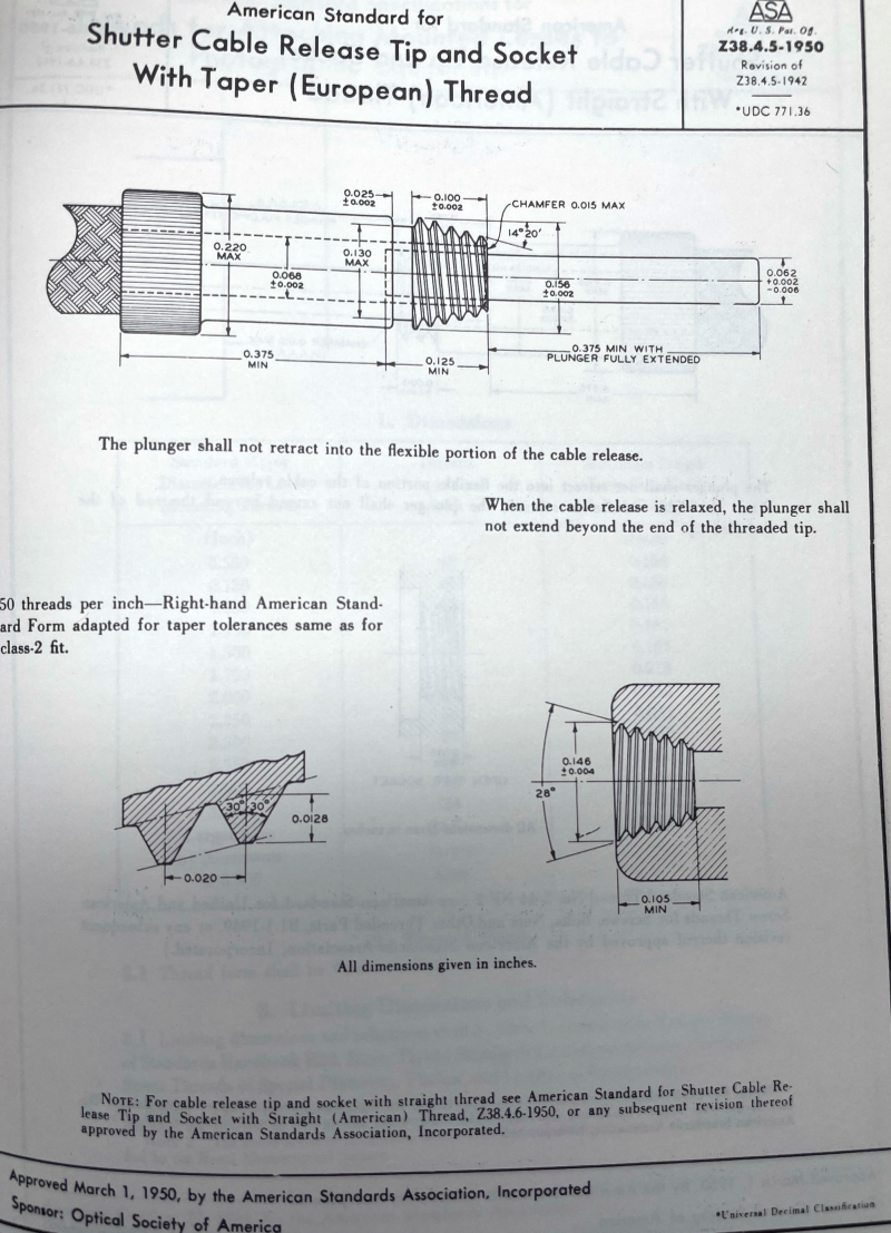

Can anyone offer any details about the screw thread used to connect remote release cables to shutters?
I can't find any info on this site.
I know they are unusual in that the threads are tapered. How are they formed?
Is it possible to buy a drill bit / tap / die set to create your own?
ANY information gratefully received.

-) there are two of such, the american with straight thread, the european with conical thread; you likely refer to the european one
-) it is a thread standardized by german DIN standard
-) it is cut by a tapered tool, similarly as is done with any straigh thread too
-) a tap is in the 200€ range, thus exchanging a button is the way to go in most cases

IIRC , the just if it was , for a tapered tap you need a special tap that are very hard to track down .

Before American camera makers adapted the tapered thread for mechanical shutter release cables, their cables had a no. 5-44 thread.
