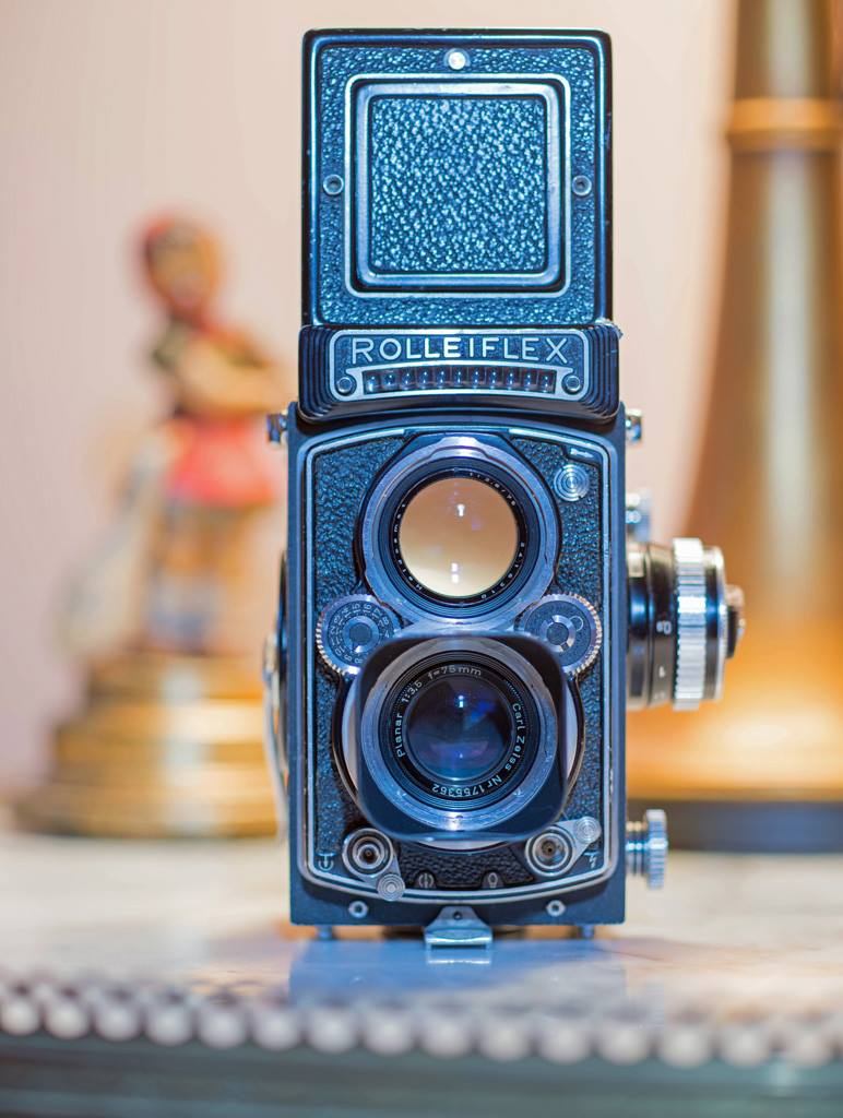

Don’t miss out on life.
Don’t die with a regret of not having used a Rolleiflex to its proper potential.
The Rolleiflex pre-F series have one single weak point: the dreadful screen. Buy a Mamiya RB/RZ 67 screen, dremel it down to the same size as the original screen you are now going to throw to the garbage, and let the camera bring you JOY every single time you touch it.
Die happy, knowing that you used a ROLLEIFLEX. Let your entourage die happy, now that they have been aimed at with your ROLLEIFLEX.

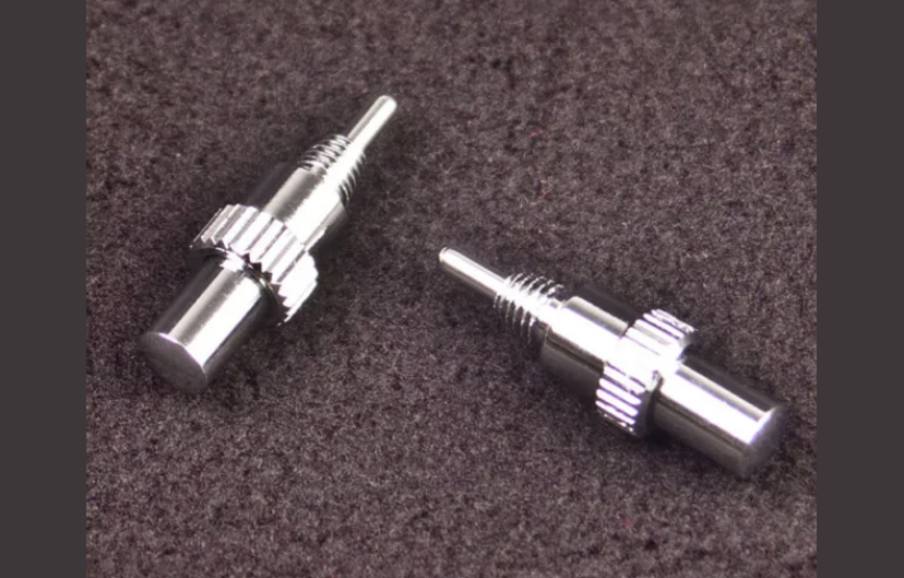

D62E1E20-6B00-405E-8562-59DD6330B474.jpeg 36FAB515-3412-44C2-97FA-31E15E0293D0.jpeg D77F8935-88DD-4645-8DCE-2FB950C0E1A5.jpeg
NB23- I recently acquired a Rolleiflex 3.5 E2. It has a removable finder. Do you know if using an RB screen requires a focusing calibration? Appreciate your info.
The removable top rolleiflexes won’t need calibration. The non-removable top models supposedly would need a slight calibration, from what I learned on google, but so far the rolleiflex 2.8E and my rolleicords are still focusing accurately. Or within my own personal acceptability, which is pretty narrow.
I cannot stress it enough: all the non removable top rolleiflexes and rolleicords have absolutely horrific screens. It’s a shame because the view, the screen, is how a user defines his shooting experience.
The upgrade that a good screen brings to non-removable top rolleiflexes and rolleicords is Gigantic. Everything changes. I don’t understand how come this weak point was accepted by the company. It’s like if the fines Armani 3-piece suit came with a tie made from toilet paper. Nice way to ruin the whole thing.

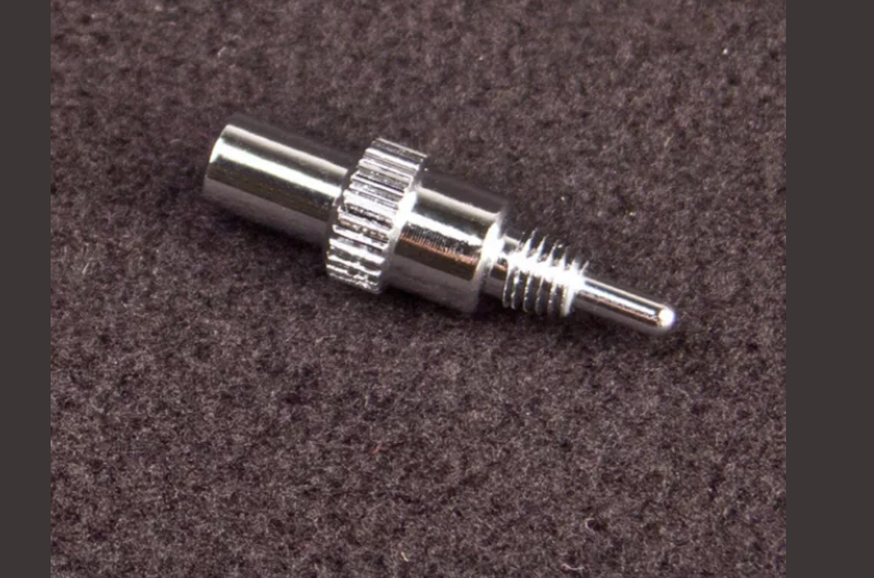

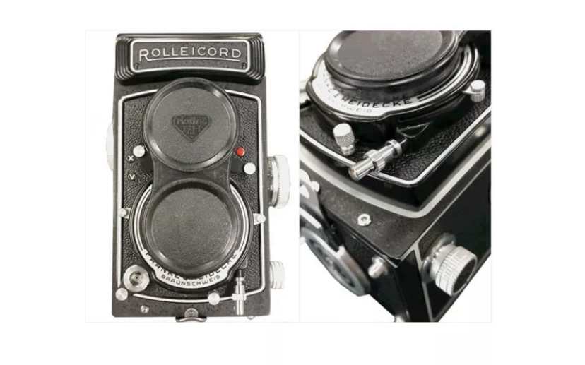

Oh, and another huge upgrade to any Rolleicord, besides a mamiya screen, or a very respectable Rolleiflex screen that comes from a 2.8F/3.5F/T, is to install a shutter release button such as the one I have attached to this post. This shutter button transforms the rolleicord into a nicer rolleiflex shooting experience.
