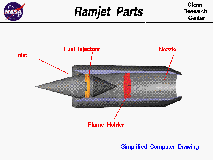

Oh sorry I made a little misstake from spelling : Ram Jet is wrong.
Perhaps because I know RamJet as term a little longer in comparisson to Rem-Jet.
Well -
this is a RamJet Turbine !
And here it is in action :
with regards

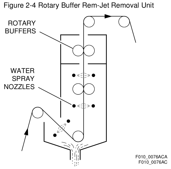

The dorsal carbon layer is the best antihalation layer (rem-jet) for the color negatives films.
For the positive color films, the antihalation layer was replaced ~ 1995-2000 with other light retention systems. (mare ecological)
As early as 2000, the color positives films had no graphite on the back (Agfa, Fuji and Kodak).
With my English, I think rem-jet comes from "remove" and "jet" refers to the water jet for cleaning the film.
The water jet is very important to be perfect (line) to clean the support.
You can read more about the dorsal graphite removal systems here:
https://www.kodak.com/Kodak/uploade...t_en_motion_support_processing_h242_h2402.pdf - page 2-6 .. 2-8.
High-speed filming uses also negatives that do not have dorsal grafit layer and is no problem.
The dorsal layer must have three properties: antihalation, antistatic and anti-twist.
George
