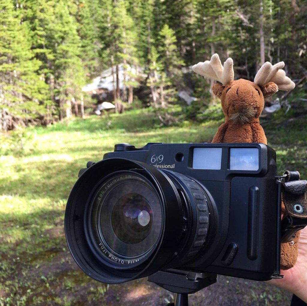

I have the GW670 II and the GSW690 III... no issues with reliability... great lenses... fun to use, even Mortimer like using it!
