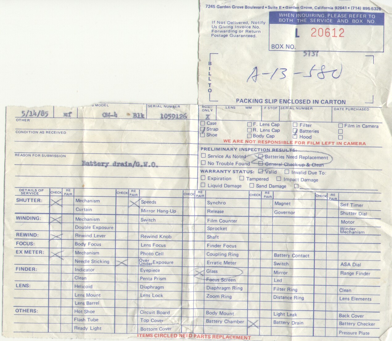

Bill Burk
Feb 9, 2010
9,221
Bill, Do you know if you have the updated board in your OM4 that doesn't too much power? I understand that you can test for this by engaging BATTERY TEST. If it automatically stops after 30 seconds, you have the updated board. In this case, I don't consider this an electronic failure as it was designed that way. I understand that Olympus offered board updates back then.
Both have the old circuit board... I sent my first one back twice, both times they told me "Batteries Need Replacement"...
As late as May 1985 the new board (or memo about the problem) hadn't gotten out to the Garden Grove engineers.
But I'm used to it and I carry spares. I've carried the OM-4 on many backpacking trips, where I've carried three or four spare pairs of batteries... and I've only ever have had to replace batteries "twice" on a single trip. Never had to replace them three times.
There have been times when I had to replace the battery at "inconvenient times". Like this sunset at the Camp Nelson Lodge... I setup for a shot of afternoon sun hitting Slate Mountain... when I first fired the camera was dead. Folded the tripod, walked back to the bar (ok that wasn't so inconvenient)... sat down and replaced the batteries as I muttered something about being prepared... then went back out and got the shots.
It's a matter of general principle though. I recommend having one electronic and one mechanical body for any camera lens mount that you use... Some electronic cameras become doorstops when the battery fails.
