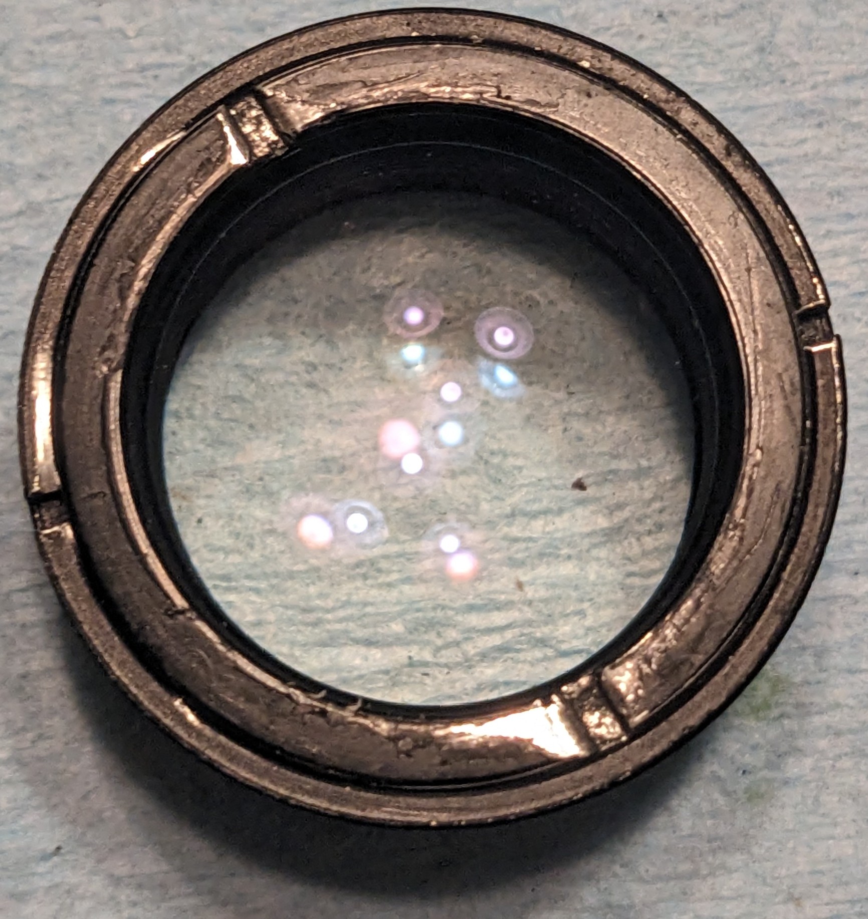

OK so here it is. I have a feeling there may be a burr in one or more of the channels cut for the lens wrench. It threads in by hand up until the point in the picture then things get tight. Maybe a bit of sanding or filing would help.
Then a bit of touch up!

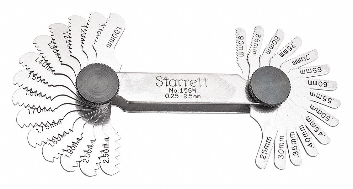

It could be the slots and the removal tool distorting threads, as you say. You can run a knife tip or such along the threads and possibly remove any burrs. Often such threads are standard. So a screw's threads will match the retaining ring thread. Meaning that '.5' threading is .5 threading, on a 1.6mm screw and on a 30mm retaining ring. I mention this in case you don't have a thread gauge. I've used a thread gauge that matches as a 'scraper' to help restore threads. Or at least as a feeler gauge that can show where the threads have gone bad. Then a 60 degree file can be used to clean up that area.

I agree with Dan, and can only add the wisdom to be careful and don't  Rush it. 😉

Thanks Dan,
I will pick up one of these gauges. It looks very useful indeed.
